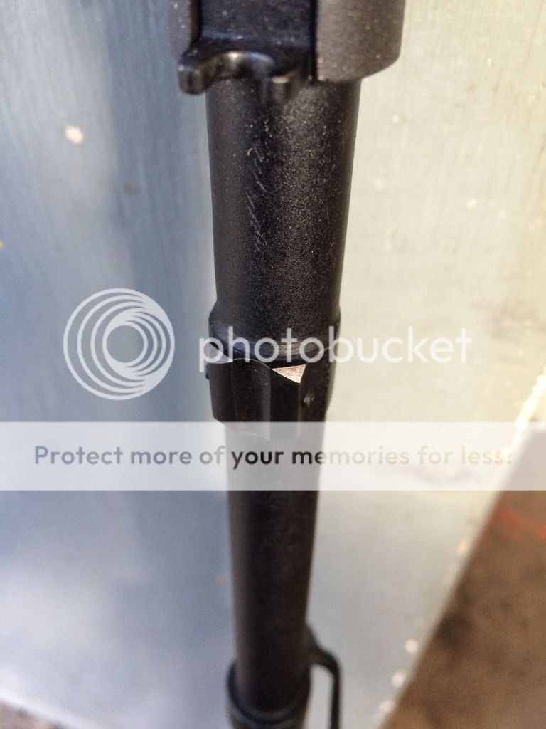

To the OP, why not just cut the Bayo lug off? That's what I did to mine. I figure it negates the extra weight added by the short muzzle brake from Hical.

Thanks, as for the muzzle brake it came on the gun when I bought it, and it's on there TIGHT! However I don't know how the previous owner mounted it as its not pinned like it's supposed to be. It's just on there. And TIGHT!
I like the rear peep. Mainly, I like that I can still take the gun apart without tools and it's better than the leaf sight.
Id say cut the bayo lug off, either add that short pin on brake that Mikeystew has (which is a GREAT little brake from my experience) ... OR pay hical the $69 to thread your muzzle for 14mmLH to accept AK muzzle brakes...
