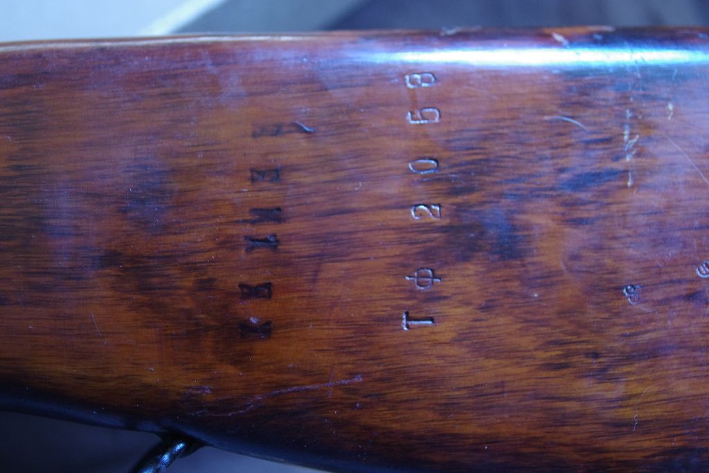

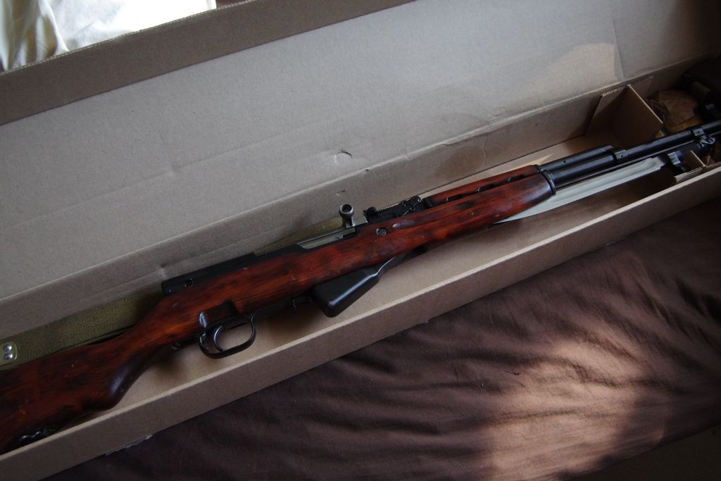

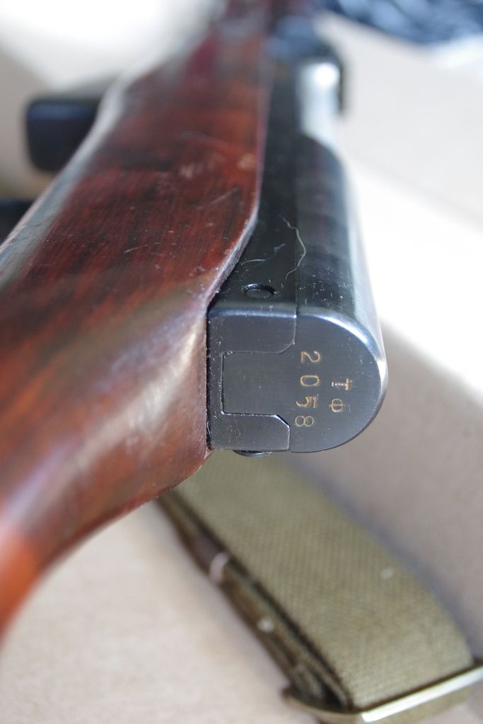

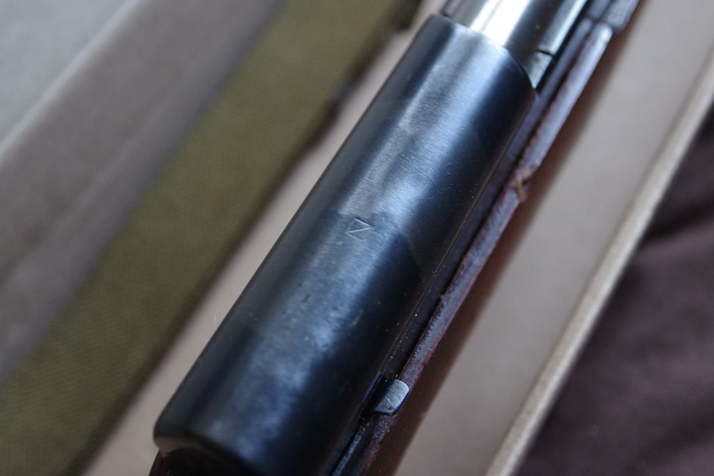

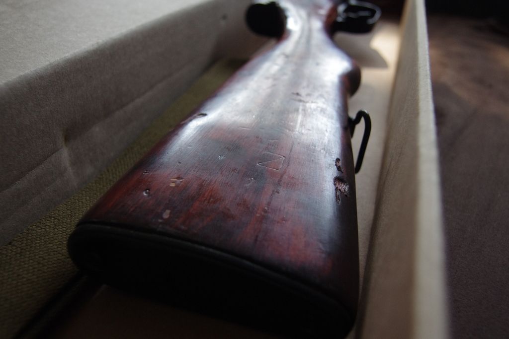

In my quest for a cheap shooter SKS I picked up this "new" in box one - looks like as it was sold from wholesale sports. The numbers all match, except the mag has an electropenciled number that is different. I assume it's a run-of-the-mill SKS, but I want to make sure it's not special before I start using it. What can you guys tell me about this fine piece of soviet engineering? Thanks for any info!
Just a run of the mill shooter sks, the square with the line through it means refurb, no date on the receiver cover I think that means its a later one like 1955 or 56? Not 100% sure. its a nice looking sks though!
If it's later that means a chrome lined bore, right? Thanks for the info.
Refurb 56-58, nice bluing, have fun, don't forget to clean it well and make sure the firing pin rattles in the bolt, if this is your first, there are lots of YouTube videos on cleaning and even one in the stickies above! Cheers.

Nice SKS, now go beat the sh!t out of it at the range. Run er' hard, that's what they were made for. If corrosive ammo, clean it well and it'll last you a long time. Well made rifles.
If the bore is chrome lined it will be obvious. The chrome plate usually overruns a bit on the muzzle and is starkly obvious against the blued steel.
Good looking SKS. None of my refurbs look that good. My Weimajack does look better than that, but I just keep it to gaze upon.
If there is no obvious chrome at the muzzle, the extreme shine of the bore, compared to every other rifle, is, IMHO proof of a chrome lined bore.
