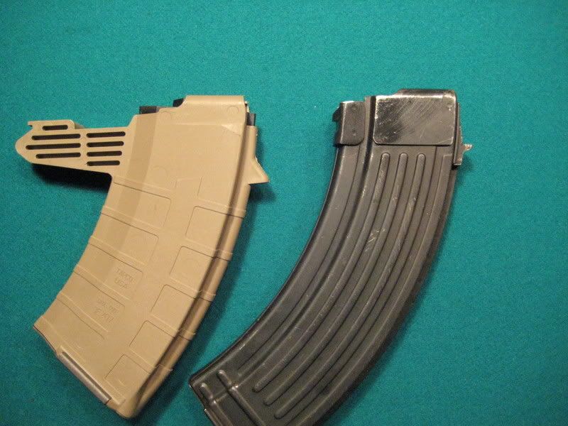

When i got my sks the only mag it had with it was a 30/5rd magazine which i believe is an ak47 mag. It locks into the weapon but falls out when shooting bcuz its worn on its clipping points. I got a couple tapco 20/5rd mags and thot they would work but they dont seem to fit.
Am I doing something wrong?
weapon specs:
chinese norc (mc-5d)??
the rear locking point is in a different spot....why is that and what will fit and work reliably???
weapon specs:
you bot the wrong mag, the tapco mag is for a regular SKS , not interchangeable with AK mag . yours uses AK mag.
lets try to fix what you have before buying any more mag. i dont know what clipping point you are talking about so a pic of it would be helpful.
Curtton is correct, you have an sks-d model that takes ak47 mags. The tapco mags you bought are for regular sks rifles.

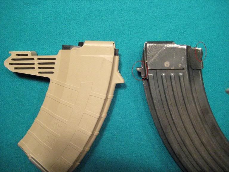

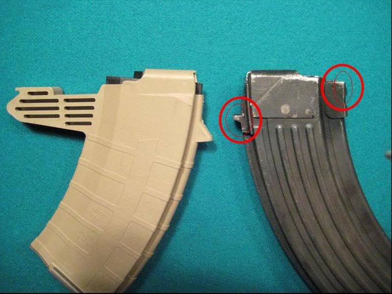

circles in the picture are the two "clipping points" that the mag clips into the weapon. Both are worn badly and are probably the cause/contributor for it falling out.
My best option for a new mag is just another ak mag??
Wheres a good place to pick one up?
Wheres a good place to pick one up?[/QUOTE]
place an ad on EE, there is always some there.
have you tried filing below the front catch? creating a deeper notch.
