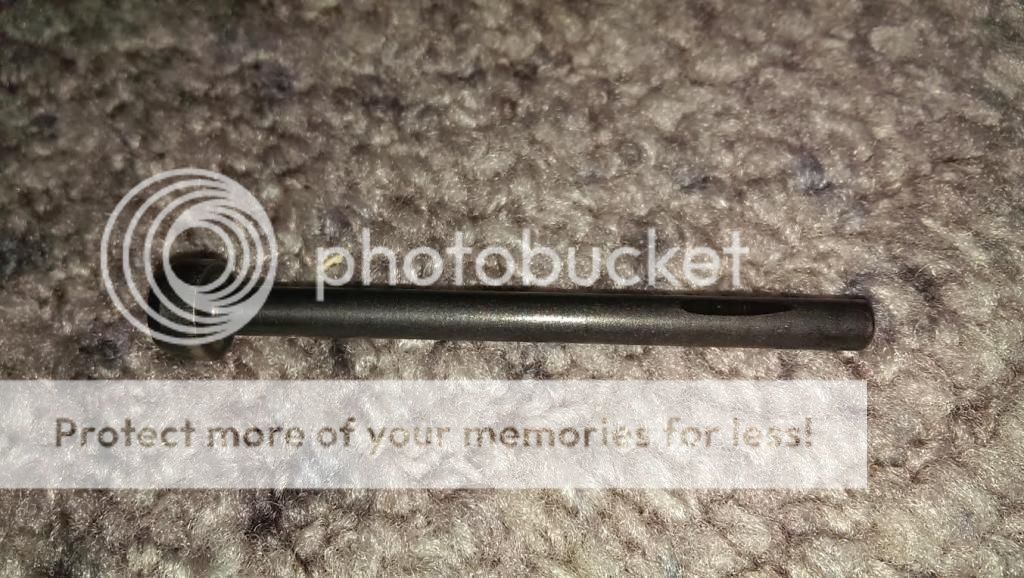

So I looked everything over, the spring seems fine, the rod seems straight, but i'm guessing it isn't supposed to have a flat spot on the top?

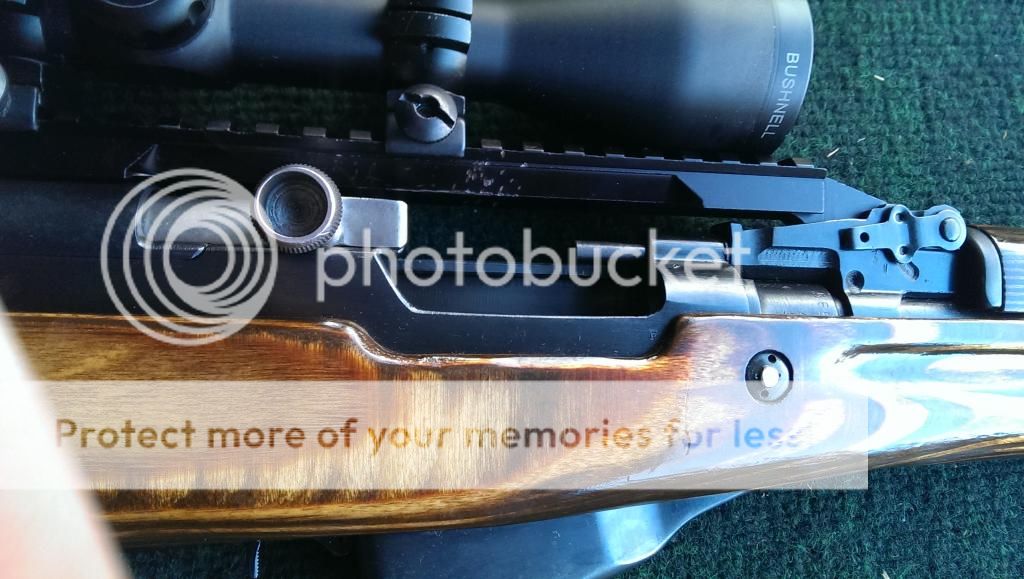

Also, here is a picture of how it looks after the last shot, just fired 80 rounds through it with no malfunctions though so I don't know how big of a deal it is. I just don't think that this is how it's supposed to function. It didn't used to do it anyways :p
The flat spot should have a small indentation - this is where the hardness was checked after heat treatment. There will be one on the piston rod too. These are not defects.
Check the back of the gas tube where it was ground to fit at the rear sight - a burr on this surface is common.
In the stuck condition is the gas piston forward or is it also held rearward?

It may be just different but your lock/take down lever for the gas tube is up or not all the way down.
I would double check clearance on the OP rod with out the spring to make sure it moves freely.
The piston may be sticking in the lower portion of the gas tube. A good scrub with a bronze brush maybe?
Now I also noticed you have removed the original rear sight. IIRC the top of the OP housing is exposed if you remove the sight.
Also could there be a chance the rail mounting could be putting strain on the block especially in the fact the take down lever appears to be partially up. Try shooting again BUT remove the rail and put back the original rear sight.

The lock /take down lever only stops the rod from moving forward for removal. If the rod and spring functions and moves freely, its likely a problem with the gas piston sticking in a portion of the gas tube, eg; crud, grease, rust or a burr.
Yes, did it function fine before installing that rail?
