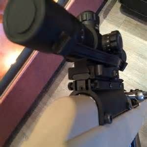

Id suggest a drill & tap rail to support your optics, and on top of that maybe the Primary Arms 7.62x39 4x optic ( i have no experience with this optic though). Hical.ca can thread you SKS muzzle for AK brakes for $69, it wont be perfect, but it will be far better than all the clamp on / pin brakes. Id also recommend the sevensixtwo systems mag release, it will require you to mod your mags slightly, but it is hands down one of the best mag releases on the Canadian market.

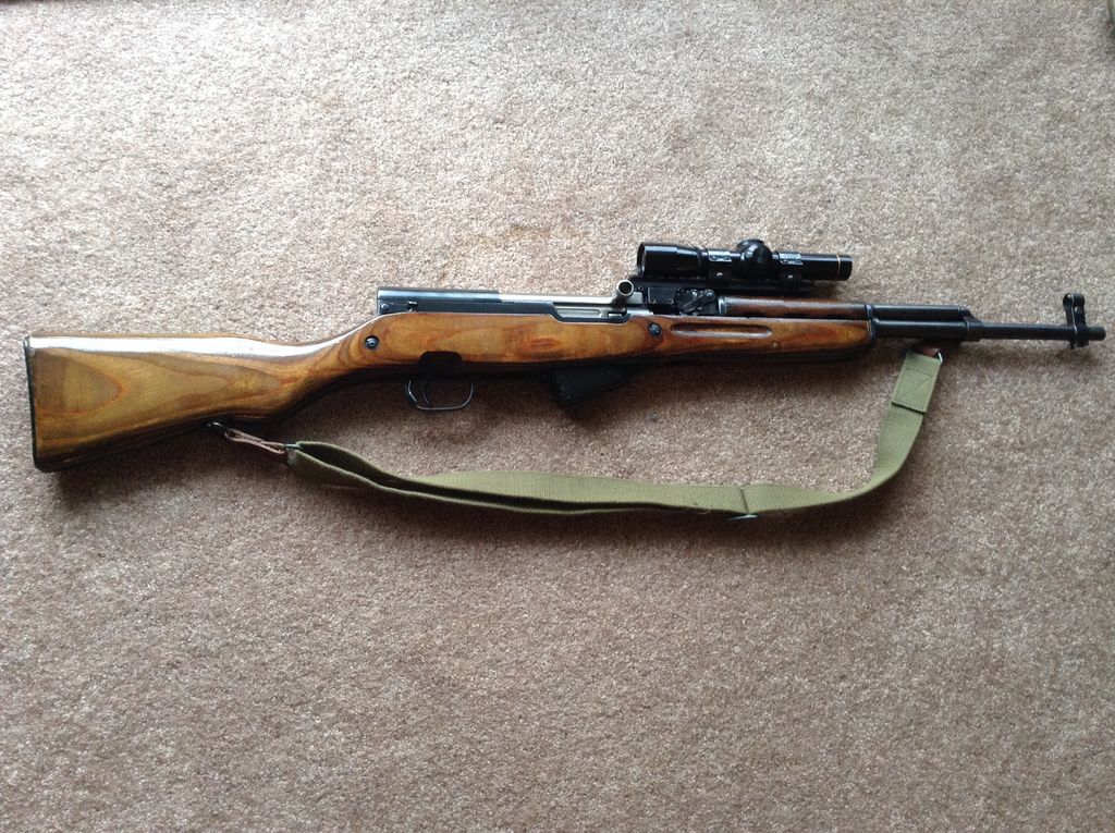

This is Sasha, My current take on a "modern SKS" It features all the mods I suggested except I went with the Russian side mount optic. Which id only recommend if you really enjoy the added "Russian touch".
How accurate are your shots with this gun and scope? What would you say your max range is?
With good ammo, Id say 5 shots within 2.5" @100yrds (naturally, 3 shots is much smaller). My Archangel stock does have about 1/8" forward and backwards play in it though... people say having a gun bedded tight is key to good accuracy so I intend to lose the Archangel stock and build a Laminate SVD stock this winter, and bed the action. Next summer I'll have to do a in depth accuracy test. As the gun is now, im often comfortable at engaging coyotes out to 250yrds (never had to chance though, the coyotes are too afraid maybe haha)). But everything its killed so far has be 100yrd and under.

Do you believe the accuracy cap is due to your skill or the gun itself? ( With the scope are you aiming better than it can shoot? )

id say Im capable of holding it within a inch @100yrds, so the inaccuracy would mostly be the gun. If you can get a SKS to pattern 5 shots within 2" @100yrds, id say your pretty golden.
You bedded your Archangel stock ? or just your mosin ? I looked into bedded the Archangel stock, but people keep telling me getting a bedding compound to stick reliably to polymer is very difficult.
