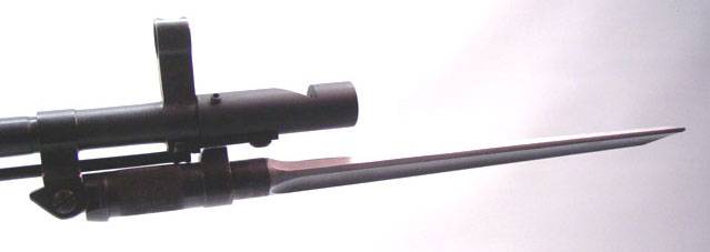

Call me old fashioned, but I like the looks of the bayonet on my sks, but I would like to put on a muzzle break on it. Does any one know of a way to do both? Not interested in comments about why it does/doesnt need a break, or does/doesnt need a bayonet.
Could you cut the loop that goes around the barrel off and have it go that way? Thanks in advance folks!!
If you install muzzle device on your SKS, then your bayo will only serve as monopod. The only way to make it work as intended is to have a tab welded on the bayo handle in L shape instead of muzzle ring and a hook at the bottom of the brake. Then when you ingage it, L shape tab will swing up and hook up with the hook on muzzle brake and spring tension will keep it in place. Just make sure you have a screw type muzzle brake as other types will fly off with few shots.
