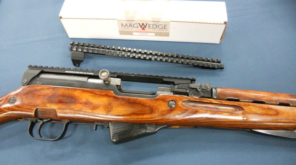

http://magwedge.com/products/rifle-accessories/sks/
Our premium grade is better than anything on the market as it is a full length rail made from a single piece of aluiminum.

Mag wedge.
Would it be difficult to single feed ammo under that rail?
Very easy, that is the original way I intended it to be done after rail install.
The Tapco mag argument is a way to satisfy the objection over lack of stripper clip access, but in no way does installation of the rail make it necessary to trade your original mag for a detachable.
I run a magwedge kwikrail and Tapco mags in my SKS. IMO the advantages of a picatinny top rail that keeps zero outweighs the loss of stripper clip use, especially when mitigated with the use of detachable magazines.
