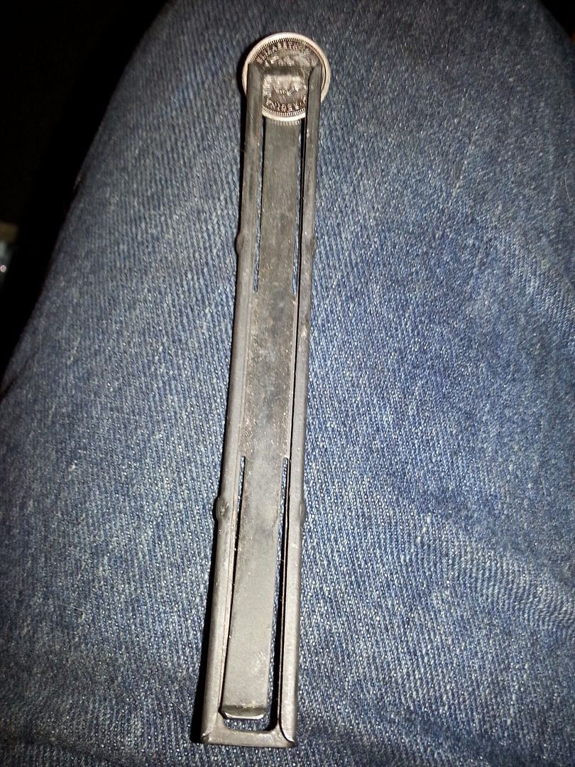

The most useful modification in the sticky is the production of 5 round clips. This is easy to do and very effective.
ummm ....This works better..Cause your rounds don't fall out after you pull the dime out ;)
