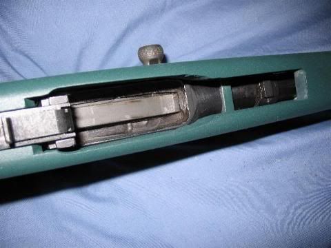

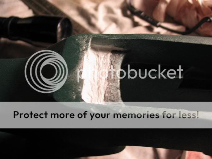

took a old ati stock and started playing with it[its my buddies rifle actually , i asked him if i could use it as a project as i shoot it more than he ,lol]started by cutting off the bits i didnt like from the stock,and filled in the area at back of the receiver where it had been butchered before.its a sks 'd' by the way and the receiver wasnt fitting back as far as it should ,so had to fix this as well .its a little more than half way there now.looking at a 1x red dot of some kind like a bushnell trophy 1x28 dial in electric,any ideas on choice would be appreciated as i know little about them in general.the pics show a scope in place ,but this is just to get an idea,also the trigger group is loose in pics as was tightened up the fit to get rid of movement,althogh this makes it a little harder to remove.

It looks like you've done a lot to it, but upon closer inspection all I can see is the missing ducktail (the little kick-up at the back of the reciever on the Fiberforce stock), the missing front sight/bayo lug and the paint job. Obviously the bedding/inletting work you've done won't be visible. How does it shoot with the stock fitting the reciever properly? Any wonky barrel harmonics going on with the front sight missing? Did you notice any difference in accuracy, recoil and muzzle flip? The reciever cover pin looks like it's been replaced with a bolt, was that part of the project also? Does the scope mount hold zero better with the bolt as opposed to the pin? Sorry for the pop quiz :p

I also bolted the reciever cover on and ran a bolt through the reciever into the trigger group and sucked it together . takes a little longer to strip but it shoots much better .

thanks for the input so far guys,this is a fun project for me,and the first time i've tried to do something of this sort to any stock other than filling in the selector switch and painting my[m305] m14 syn stock, so its a good learning experiance for me. duke1;that aimpoint looks ###y,i'd like to hear some about it [is it robust?how many rounds have you fired with it on and does it hold zero well? poweredby beer; yup ,its a bolt alright ,and i can put alot of force on that rail and not detect any movement. this stock also had goofy looking ears at front that covered the hand guard,i cut these off as well.i've successfully lost the front site [i gave up looking for it now]its not ready to go to the range yet ,but i'm hoping the end result will be decent groups without any flyers. emmab; i've looked at that mount and do like it better than where i've got it right now,if i'm not happy ,i'm going to try it. rupzuk; the paint is rustolium textured finish in what i would say is dark forest green.it leaves a nice rough texture i like and does seem to be tough.i'm trying to find a matte clearcoat to make sure its durable although i may have to spray over top again to regain the textured finish. i've got a nice tight lockup with the trigger group now ,it takes a good smack to lock it up ,but now has no movement that i can dettect. oh, btw ,that idea for a muzzle break is good poweredby beer,i almost missed it.i think this is going to be my rifle soon as my buddies got my jungle carbine.

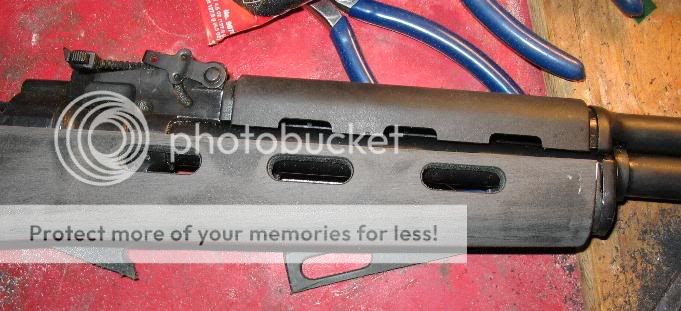

well,here's my progress so far,shortened the stock now to make it handier[actually feels more comfy that the mags aren't where i want to hold it. finally happy with the way the receiver is fitting[tight]also included a brace to stop any forward movement that was happening.i have to admit this is taking a little longer and more workthan i had thought .still wanting to put a brake/suppressor on it,hopefully soon.the more i play with the sight the more i'm thinking i want to try a scout scope mount
. just going to have to shoot it soon to get a feel for it the way its mounted now
