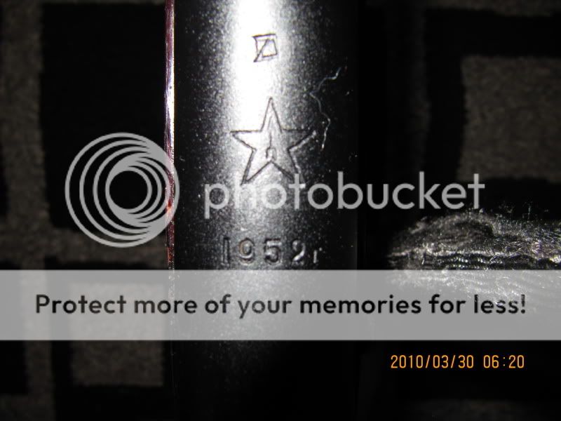

At present, I have an unissued '51, a '52 refurb that looks as though only the stock and gas cylinder got changed, and a '54 unissued. I also had a 55/66 no-date in issued, but non-refurb condition for a while until recently. I've owned tons more SKS's over the years, but my previous ones were beat up or refurbed ones from when that batch came in from Syria 15+ years ago.

The 1952 is markedly better fit and finished than the 51 and the 54 is markedly better than the 52.
