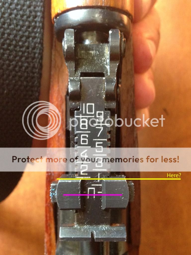

OK here is my stupid SKS question. My little slider that you move to adjust for elevation does not have any markings on it to line up with the target range index. Where do you set it? For example, in the photo, am I set for 200 yards(or is it meters)? (I know good luck @ 200 yards.) Is where the yellow line how you index it? Other sights I have seen would be where the pink line is and there would be a mark to line up with. A little 101 would be appreciated. Thanks.
Yep you are at 200 Meters. The line below the number is the index. The upside down U is the battle sight position of 300M.
No precision here. As you slide the lines on alternate sides will "line up" with the front of the slider.
So the Yellow line is your index reference location.
Thanks. Kinda figured that but not sure.
