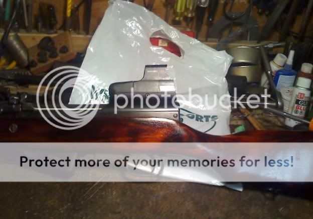

great minds think alike i guess. i built one today, ill have to take some more pics. seems dam solid, but im sure it will loosen up with some shooting. im going to drill and tap 2 holes on the back rear of the reciever, and im going to silver a flat peice to the rear of the top cover. drill a hole on ether side, to corispond with the taped holes in the reciever, and once the cover is inplace, 2 screws. dont think anyone has done it that way yet. should be way neater than the side screw thing, and be as good.
this is the first time i have ever put a holo on ANYTHING that felt as right as this. was to dark to go shoot it tonight, tomorow.
this is just a crappy cell phone pic

scope not removable for cleaning? why not? the rear cover comes off with the scope, gotta do that anyways to get the bolt out.
i dont wana interchange scopes for anything, as i do not want to put anything else on it/
stripper clip guide still works just fine, if you will notice that the HOLO sight doesnt stick out past the front of the cover.
anything i have ever had to do with a sidemount scope, of anykind, was no good. weak and wont hold zero.
im not saying yours is weak and wont hold zero, but im not a fan of them at all. once i build the added peice on the rear, like i intend to, it will be rock solid on this mount, and be removable with 2 screws
plus, if i wish to remove the scope, and go back to no scope, all i have to do is replace the rear cover. no holes in the side of the rifle, no wood removed, back to stock,
