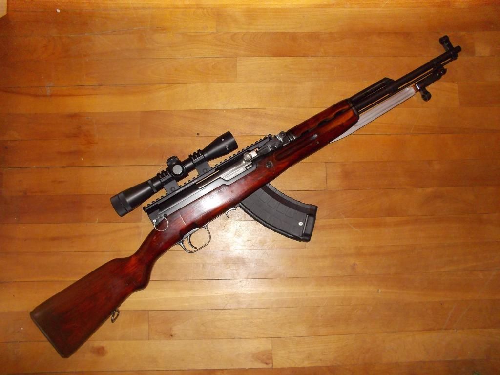

My SKS has a Magwedge Gen 1 rail and VOMZ 4x32 scope, it's a good set up. I can't seem to get better than 4MOA out of it, but it does have an unusually horrendous trigger, even for an SKS. I'll have to look in to doing a trigger job and see if I can shrink those groups down. The Magwedge rail does still leave the scope rather high, and the stock is uncomfortably short for all 6'2" of me, so consider these things too.

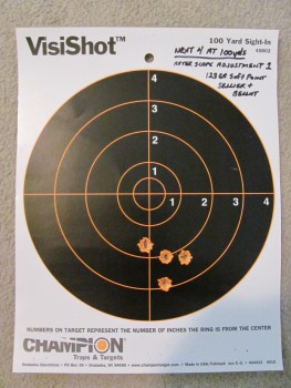

Chinese Type 56 with the Magwedge Gen 1. Shoots 1 1/2" groups at 100yds. Will smack the 300yd gong all day long with Sellier and Bellot 123gr soft points.

Pro Mag side mount..........full length Picatinny rail on top......Harold
