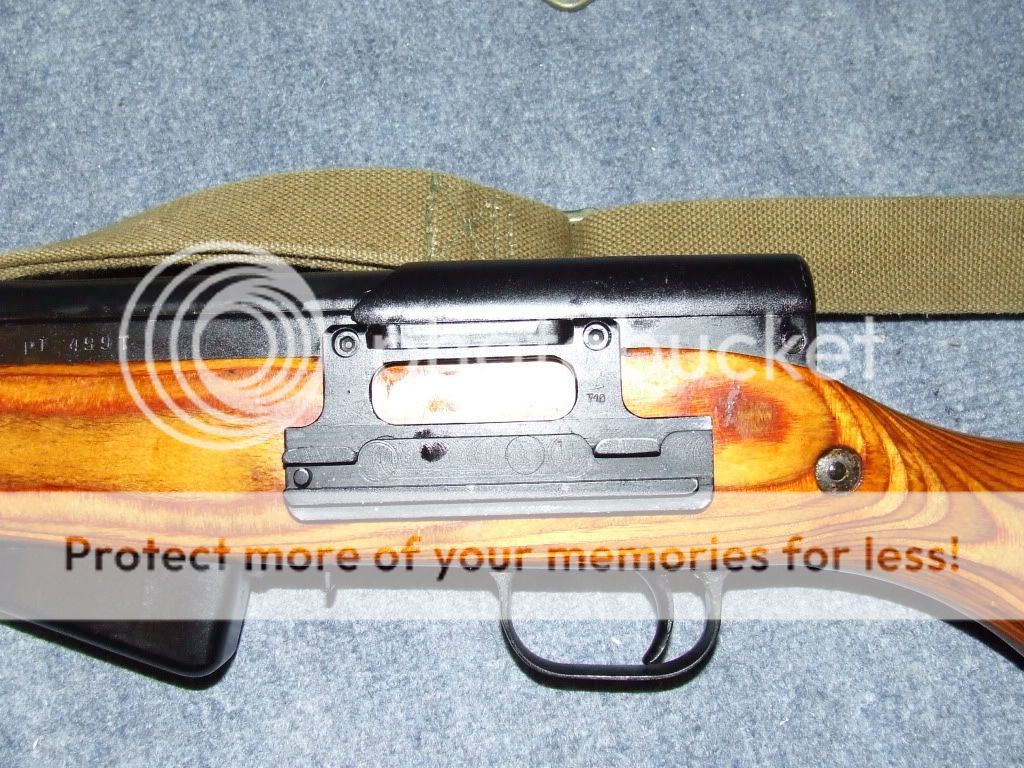

This was mine:

This was mine:
How centered is that optic, mounting to the wood instead of the receiver?
I'm thinking I'll probably go with something like that from kalinka optics, just waiting to hear if it will work with a tapco, I'm also curious about how centered it is.
