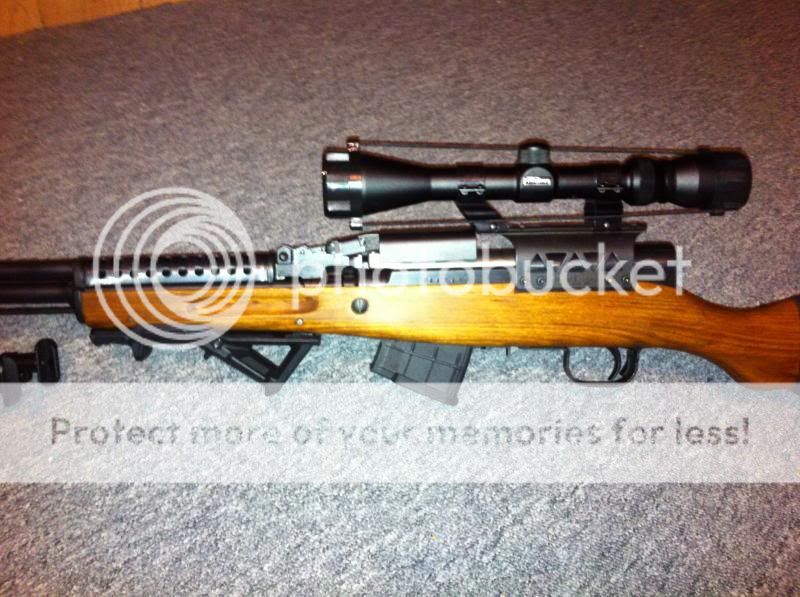

I just bought an original SKS Side rail mount, made in Russia. Pretty much same in dimensions as Choate or Promag one.
I ordered it from BC, from ebay. But on my Qs what drill size and tap size to use.. there was no reasonable answer back, neither it was shipped w/ instructions in that regard. All they said is that the screw is 8 - 40.
When I check this site: http://westrifle.com/wrstore/index.php?main_page=product_info&products_id=1524.com, WestRifle , this guys have drill/ tap size indicated and they provide 8 - 32 screws, more standard ones for taping. 8 - 32 drill bit+tap is standard, why the hack 8 - 40? The difference is 2.5 threads less per whole/screw x 4 screws 10threads less. I think it will still hold well.

No, I ordered from alex-Something on ebay, and then I was looking for the whole size to drill and the tap to use and since that ebay account was totally useless in providing simple info I looked further and found WestRifle recommendations: for 8-32 x 3/8 screws the say: 8-32: drill (1/8', I guess this is 27 bit), tap 8-32.
WestRifle which sells same product uses 8-32 scres, and this is what they say: "Soker 8-32X3/8"(4 pcs included), Drill - 1/8'HSS, Tap - 8-32 TAPPCR"
Mine came with 8-40 also and I tapped it to 8-32x3/8". You won't be disappointed with a receiver scope mount, I love mine and it holds zero 100%. A few things I would suggest is making sure it is level to the barrel, just high enough to remove the cover for cleaning and that it is set back far enough to insert stripper clips. I drilled and tapped 1 hole at the back, mounted it and then checked everything was good. I think I had to move mine back 1/4" from the measurement given in the instructions for stripper clips to work. For leveling to the barrel I had a 1" piece of pipe 3 feet long that I mounted, with rings on the mount, that stuck out over the barrel. I then used inside calipers, between the pipe and the barrel, to make sure the mount was leveled with the barrel. After that I bore sighted the the scope to varify all was good and then marked a tapped the remaining screws.
Mine came with 8-40 also and I tapped it to 8-32x3/8". You won't be disappointed with a receiver scope mount, I love mine and it holds zero 100%. A few things I would suggest is making sure it is level to the barrel, just high enough to remove the cover for cleaning and that it is set back far enough to insert stripper clips. I drilled and tapped 1 hole at the back, mounted it and then checked everything was good before I marked and tapped the remaining screws.

Well I have a synthetic stock and the mount is just at the level of the lower side of the triangle wholes... when you align it with the gun body (cover out) , no cuts required to the stock.
But somewhere I read that the mount has to be 1/16'' or 1 mm lower i.e. the lower side of the CUT triangle wholes should overlap with the gun body (when the back cover is out) for 1/16'' or roughly 1mm.
It means that I have to precisely trim my stock for 1-2 mm down.... which I was thinking not a big deal... but I'd prefer to keep the plastic relatively intact and those 1-2-3 mm 1/16 or 3/16'' the rail elevation up or down... does it really play a big role? Anyways, there is enough "meat" I mean metal to screw in, no matter how you align the MOUNT's CUT WHOLES TRIANGLE lower side-even with the body of the gun or just 1/16'' down. kind of difficult to explain.
Am I right?
