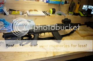

I decided to try a red dot on the gas tube rail, so I wanted to tighten the whole thing up a bit.

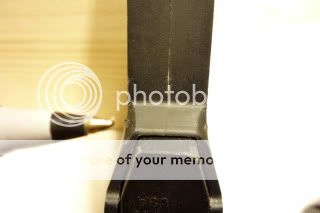

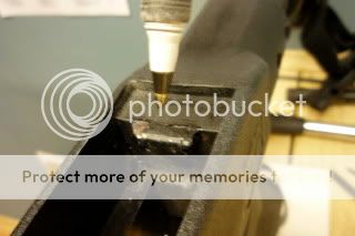

The receiver had movement front to back in the stock, so I used some puddy epoxy to take up the space at the back end. Side to side is very tight so I didn't need to do anything in that regard.

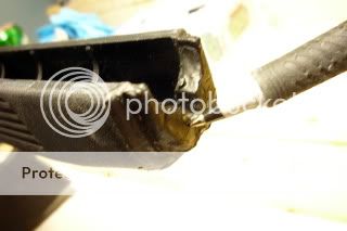

At the front end I used JB WELD to mould the forend to the barrel bracket.

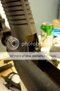

In order to be able to remove the trigger guard without removing the grip, I needed to Dremel out some material from the pistol grip. I then used JB to secure the grip to the stock, along with the screw. That sucker ain't never comin' off! :)

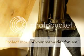

I wanted the shroud to be as securely fastened to the gas tube as possible. I used JB to bed the shroud to the gas tube brackets. I also bedded the shroud to the stock.

Well I figured I would try this out. I had about an 1/8" play forward and back on my stock. I fixed that by molding JB weld on to the front of the stock behind the barrel bracket. Took out all the play front to back. I didn't have to do anything else to it, the fit is nice and tight now.

I shot the gun with the red dot and irons. 2" at 100m shooting Czech surplus. Past that range it opens up real wide because of the size of the dot on the scope. Groups aren't any better with the dot than the iron sights, but target acquisition is faster. I'll see if it holds zero after taking the gun completely apart for cleaning next time I get out to shoot.
