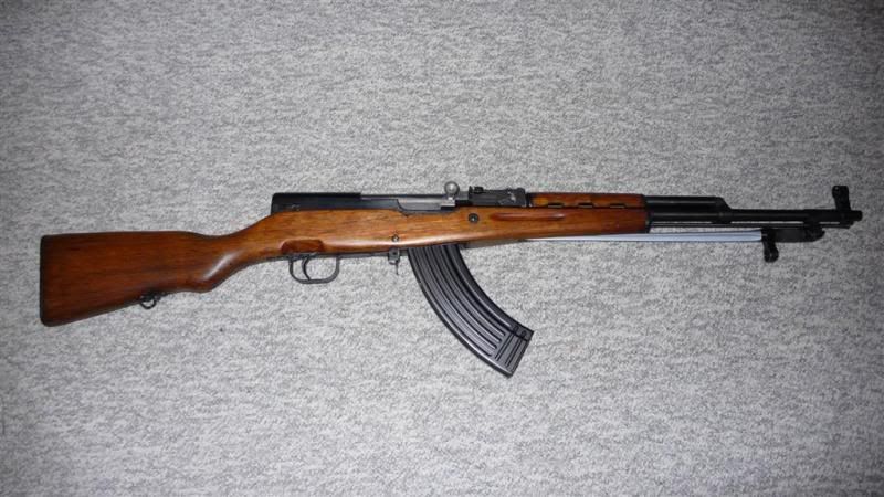

heres what i picked up a year ago from EE .
a sweeet looking "D" for about $350 so if you bot a reg SKS for $200 plus $40 for the banana mag , you need to find a smith that will do the conversion for less than $110 .... fat chance .
i was gonna restore the wood to its orginal blond but the color is starting wear on me .
