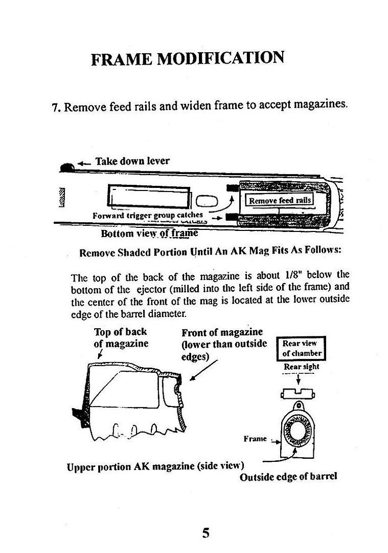

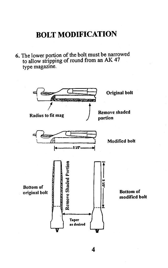

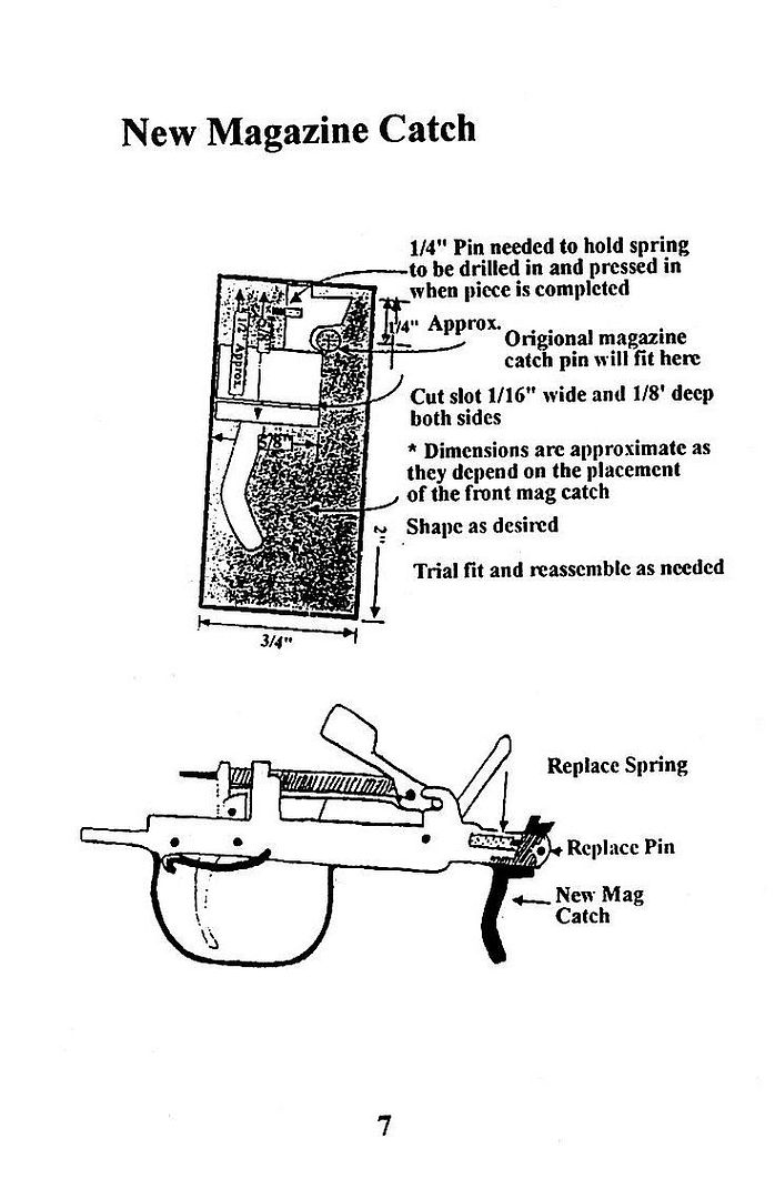

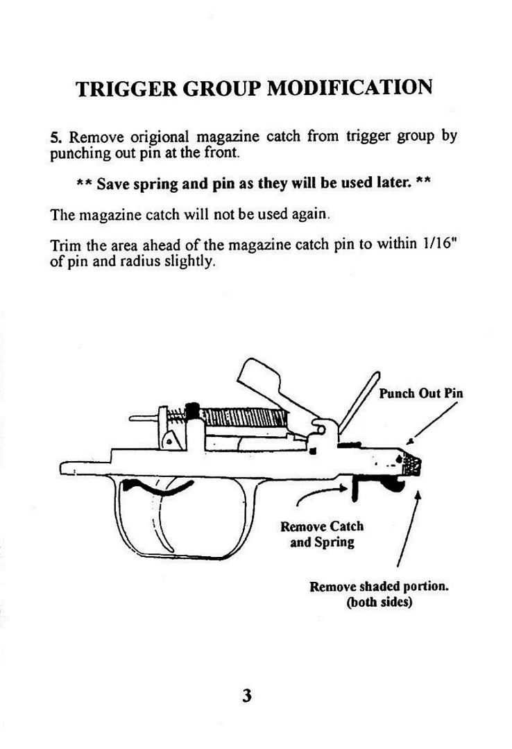

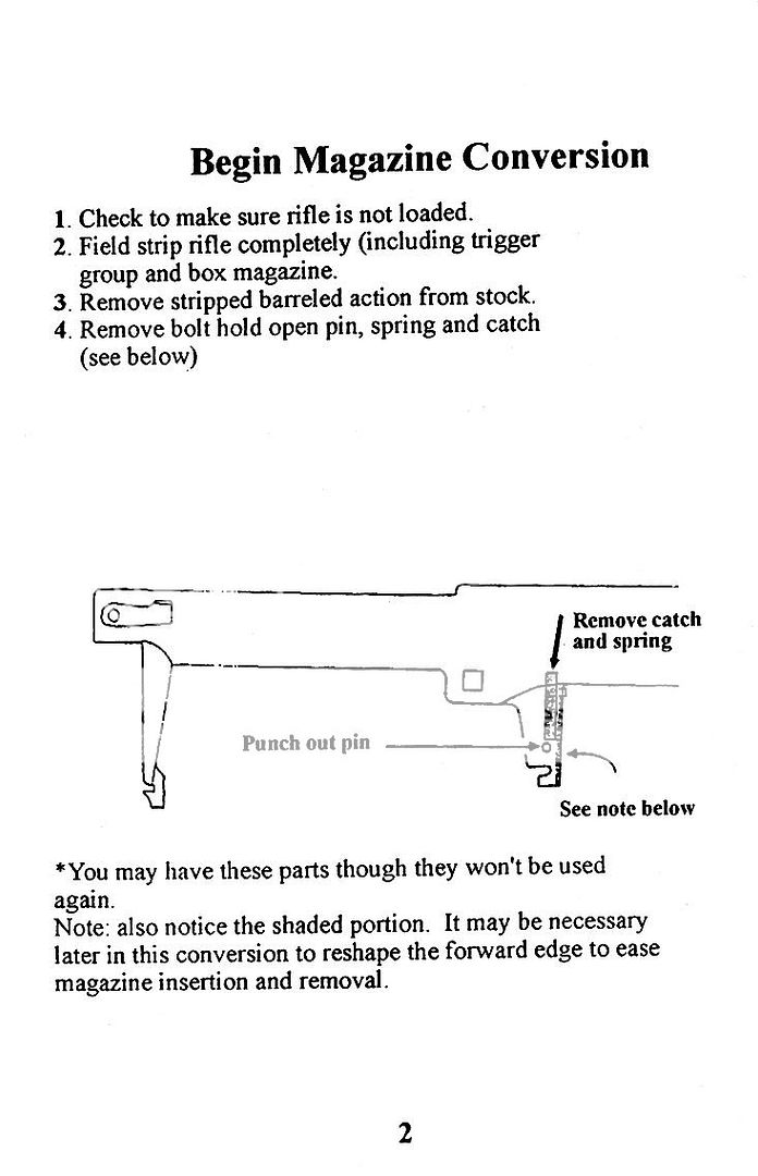

Just because I like to see someone try this out, here is some useful info for you.
Enjoy.
Cheers,
Alex
p.s. I have seen 2 sks' done this way and both work great as sks-d's.
