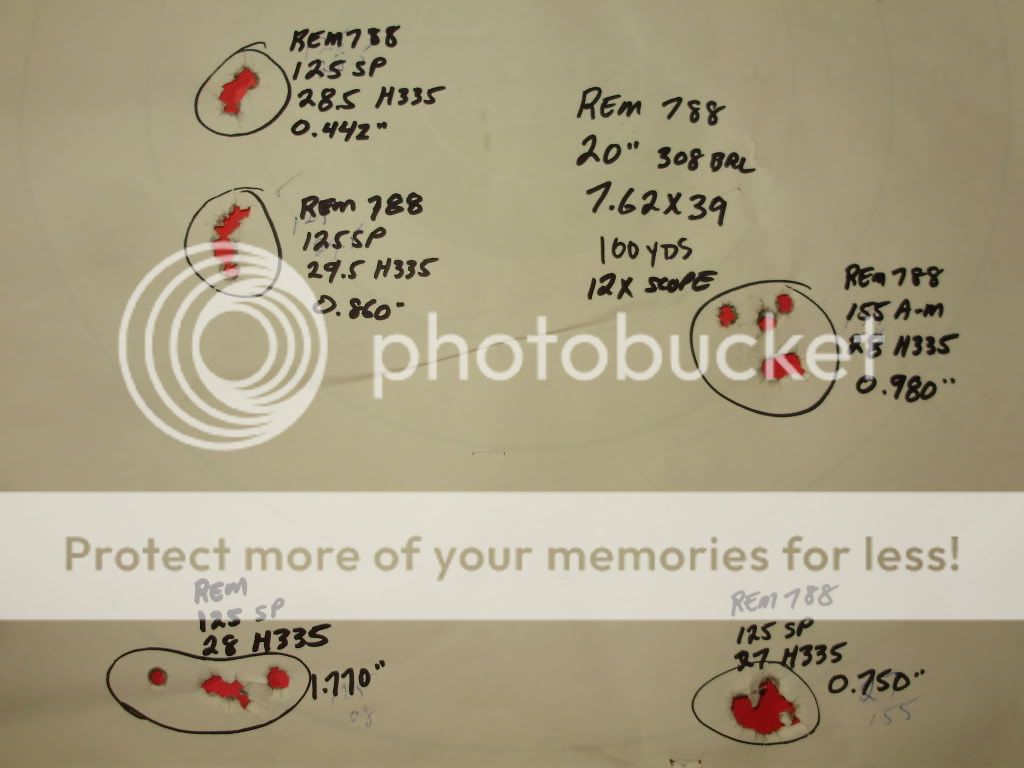

To address this question I built a 7.62x39 test rifle on a Rem788 action, using an old heavy target rifle barrel, cut down to 20" and chambered in 7.62x39. It is throated a bit deep so as to accommodate 155 gr match bullets.
The above ammo, plus some handloads with both 125 gr 308 bullets, Mexican Match with 123 .311 bullets and some 155gr 308 A-Max. This testing was done at 100 yards, and the milsurp shot around 1.5" (very good) and the handloads around an inch or bit less.
