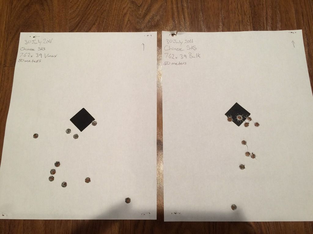

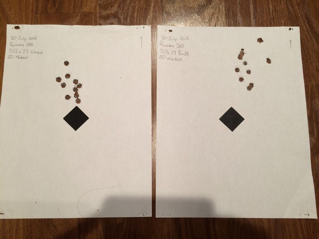

Here are a few pics of the groups I got out of the three, they are shot at 50 yards from a nice steady bench, one group is Chinese bulk (I think) and the other is from some Vmax I loaded up for hunting.
The groups in the second set of pics is a complete mess, and doesnt like the hunting ammo much!
