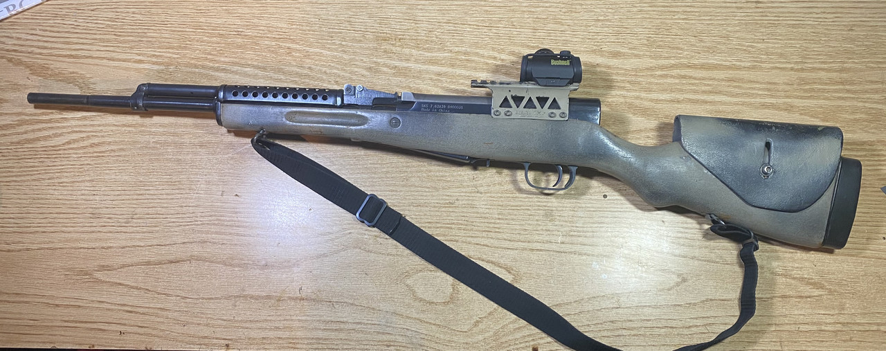

Try one of these mounts. I know about screwing around but this is what I did with a civilian Chinese non numbered 18.5”(factory) sks. Thanks to my friend Curtton, we installed this on his living room table. It has never shifted in 3 or 5 cases worth of fun. You have to be careful as too far foreward you can’t use the clip guide. Too far aft and it’s very difficult to get the bolt back into the gun. With a scope that covers the slot, I use tapco mags. The red dot is sighted in at 50 yrds and works quite well and having the option for a scope elevates the usefulness to use lots of cheap corrosive Ammo!! I think there’s an in depth sticky produced be Curtton up top on how he (we lol)did it.
wow, that mount is still on your rifle. i enjoyed working on your rifle but a chance of screwing up a friends rifle is a bit scary. lol.
i agree, top cover mount is useless.
