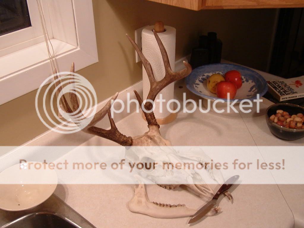

I have kept the head from a deer as I would like to process and keep the skull for display. Not a European mount but the whole skull with the lower jaw. As this is my first attempt any tips would help. Anyone out there done this before?

Clean as much off as you can first, before you boil..lol..take the tongue out the bottom, not sure if you have done that yet,
Same exact process as a euro, you just kept the jaw.
1) remove the meat -a)bugs b)simmer c)maceration
2) degrease
3) whiten
4) seal(optional)
What do you use as a sealer?
... You can then bleach it. We have just used househild bleach directly on it.
DONT use bleach. It may look fine now, but as time goes by, the bone will become chalky, and brittle. Dont believe me? ask any taxidermist/museum/science lab. Peroxide is the safe way to whiten bone.
WELL THEN...lol should I coat it in something to prevent this?
Use laundry detergent. First clean of all the bits from the skull you can with a knife; hide, muscle, eyeballs, brain etc. The fill a bucket with luekwarm water add a scoop of detergent and the skull. Let it brew at room temperature for 2-3 days, pour of the fluid and repeat. The enzymes in the detergent will break down all the soft tissues and after a couple of days you can brush/wipe all the bits off. It also degreases and whitens. Simple, cheap and effective.
