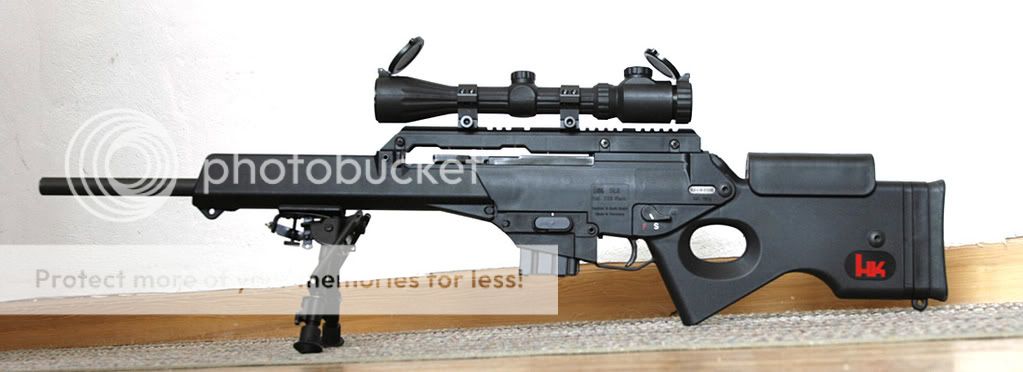

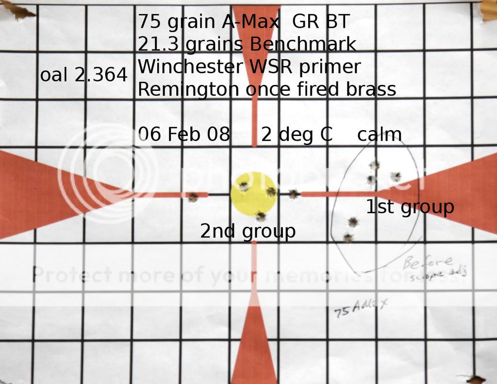

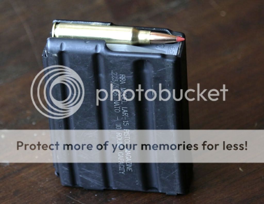

Had the gun for a while now and started developing a load. It has a 1:7 twist so the 55 grain ammo I tried first was all over the map. Found some 69 g Federal Gold medal SMK and it shot pretty well. Thought I should go heavier though. A previous owner shot this rifle sub MOA at 300 metres. So that is my goal. Another member recommended 75 g A-Max. I started the load at 20.5 grains of benchmark and I'm at 21.3 right now. One thing I'd like some help with is the oal. I can't get it short enough to load a mag. Is there a way to crimp on the area above the parallel surface without popping the bullet into the case? This is all at 100 yards to start. My scope is an inexpensive Leapers 3-9 x 40mm mil-dot LP-SCP-394FDRL3. I find it difficult to use. (That's my excuse!)

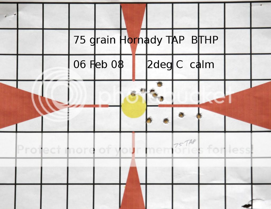

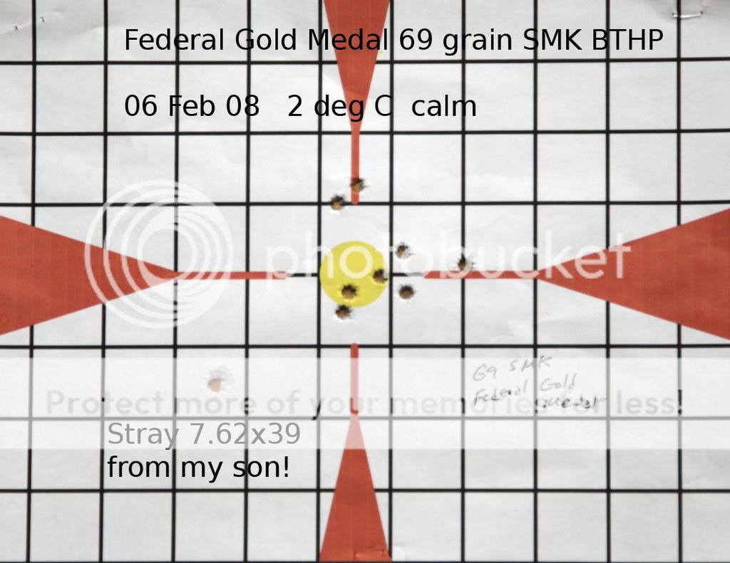

So yesterday I tried the Federal 69 g SMK, the Hornady 75 g TAP and my 75 g A-Max handloads. I'm new to rifles and the Harris bipod but the groups are tightening up. I'd like a new scope but for now its not too bad.

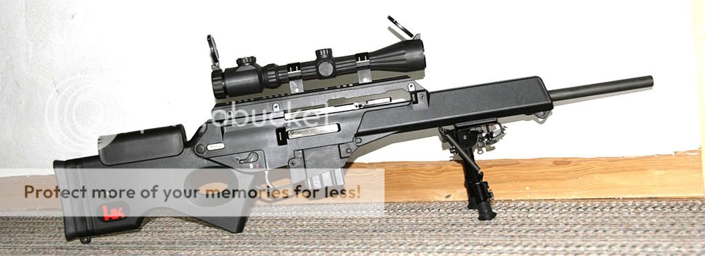

The rifle

My handload in a mag....can only use 1...in a 10 rnd mag
Targets (Had to adjust scope after 1st 5)
