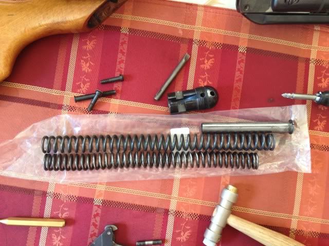

So I tore it apart pulled the crappy wore out leather piston seal off and went to a Leather Harness Shop and got him to make me a new seal. It was WAY too tight, and the gun wouldn't compress the piston. So I tore it back apart and kept woking it back and forth untill it moved nicely. I had to replace the trigger spring seeing how it was broke but worked dangerously...I bought a rubber O-ring kit to replace the barrel seal. I ordered a new BSA Metor main spring from D&L airguns in BC as well to really get it up to par......
Sorry I didn't take any pics of the new leather piston seal. I will once I tear it apart to install the new spring.
I must say though tha after I replaced that seal, I found the gun didn't seem to have the power it used too.... but maybe it's because the piston needs to wear in a bit, seeing how tight the actual seal was.... and obviously with the new spring it will have more power. Original spring was roughly 8" and new one is 9.5".

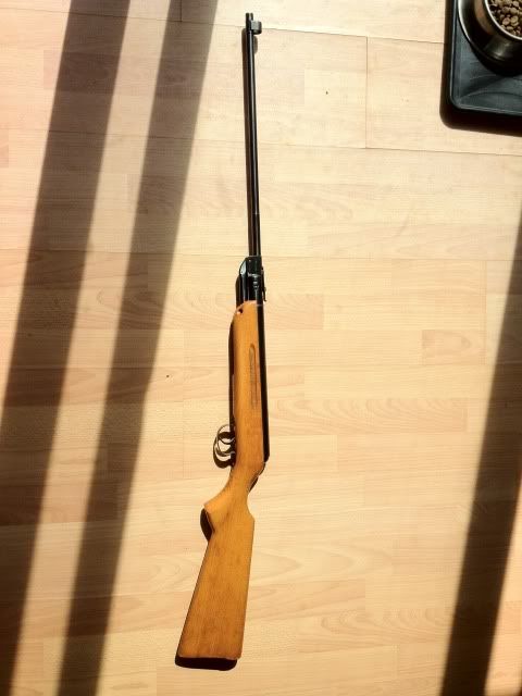

Here she is....
Oh and I'm going to rub it all down with steel wool and re-blue the entire gun....

Well I sure hope it regains some of the power once I get the new spring installed and the piston seal gets "broken in". I see yours came in at 585fps. I believe from what I have read, that the 620 should range between 575-620fps... With a spring upgrade, should come close to 700fps. I'll be happy if I can get er up to 600fps+

I paid $45 shipped from D&L Airgun in BC. That was for a BSA Meteor Spring. I found all the info from the Canadian Airgun Fourm.
Slavia 620 main spring should be roughly 8"
BSA spring should be roughly 9.5"
So I'm sure the old main spring is wore out... shes had a lot of compression over the years....

Well yesterday I installed the new BSA spring. What a difference!!!!!! I mean like wow. Then again the stock spring was wore out, but WOW! It wouldn't shoot a Gamo Raptor pellet down the barrel before, now they come out like nobodies business! lol.
It does diesel, but I'm not worred about that! It would never break a beer bottle before, like even if you put the gun right up to it. Now at oh say....15yrds, smash goes the bottle.
I do notice it makes quite a loud spring slam type noise, but I can live with that!
