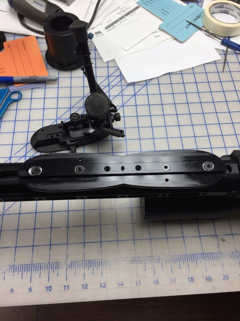

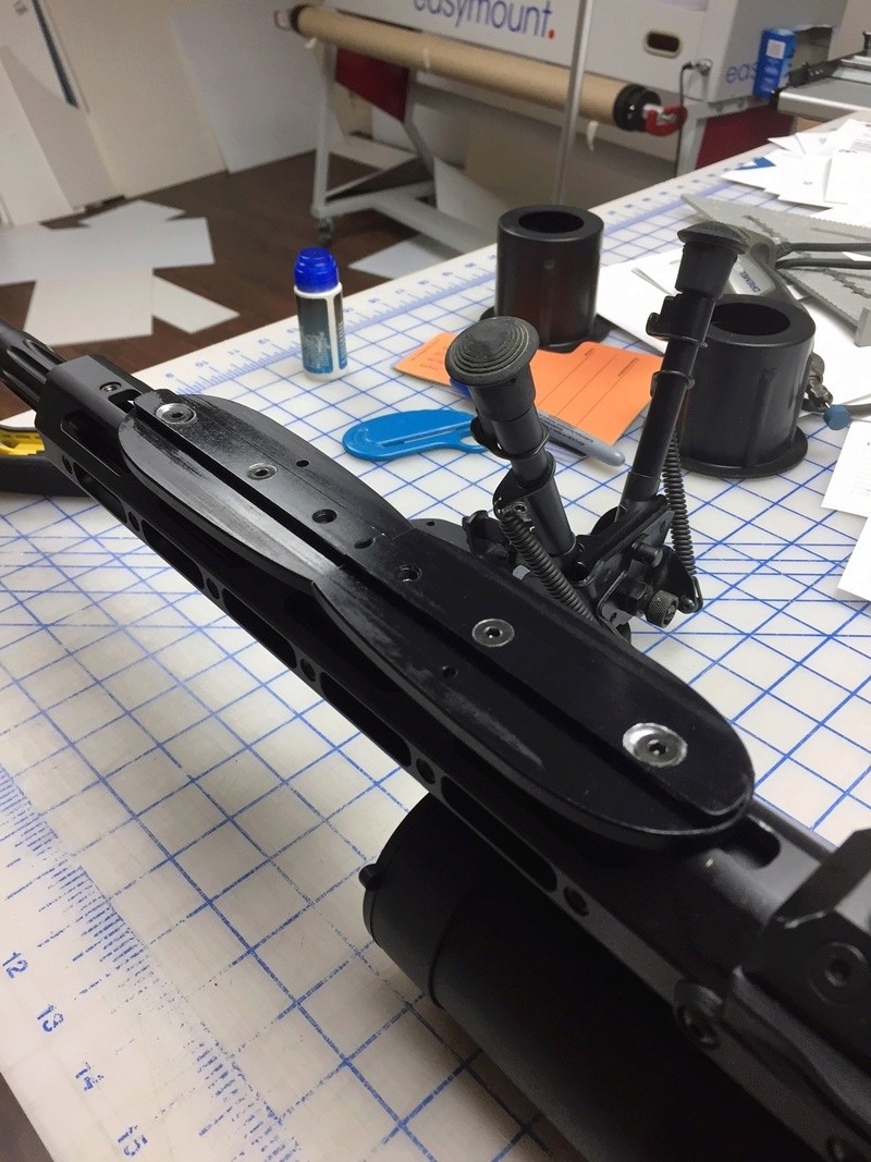

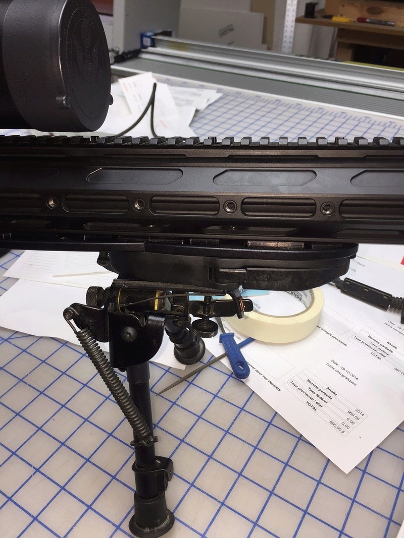

Thought you guys might like to see my latest project.
I'm a PRS competitor and field shooter, I often found myself frustrated by not having the right footprint (distance between bipod and rear bag) for every situation, wedther it's prone or from the top of a barrel I could never get optimum footprint.
I tried with a picatiny rail and quick release bipod adapter but was not totally satisfied, in a PRS stage when you have multiple barricades it took to much time to unlock the bipod and their was always a risk to drop the bipod on the ground so I had to think about something else
After much though I decided to go with a sliding system, I bought the buttpad adjustment from Cadex and took a few hours to work some magic
Now I can adjust the footprint in less then 2 seconds with no risk of dropping the bipod, just open the clamp, slide the bipod, close the clamp and voila! Optimum footprint

I brought the project to Cadex about 9 months ago, would have like it to be machined directly on the hand guard or as a add on piece of equipment but they have just to much going on right now to go forward with this, that's why I bought existing hardware and made it myself.
The end result is not exactly want I wanted but will work for the purpose I wanted it to.
