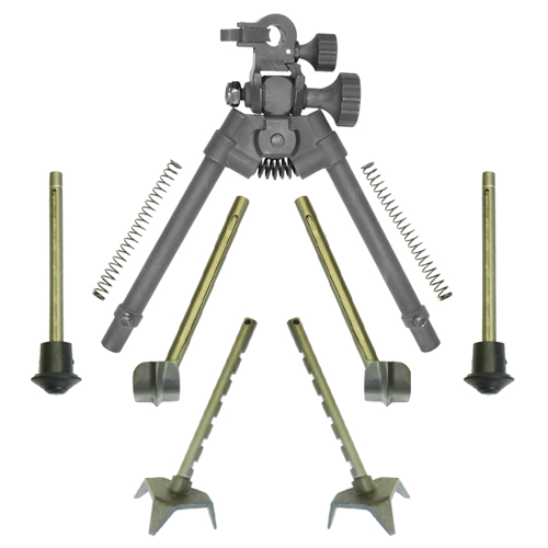

These are the typical raptor feet at the bottom. They can still jump out of position under recoil if not trapped somehow.

The ones used for PRS are typically Raptor feet made from a triangular shaped plate with the corner bent down and might bite about 1/2 inch deep. I've never seen anything longer but it might be out there.
That's better than nothing but not in the same league as what I'm referring to with 2 inch deep spikes on a recoil absorbing system for F Class. Deeper for anything else. I've even used 2 foot long rebar on occasion for real mule kickers.
I've never seen a single pair of these "raptor feet" at a PRS match. Which match did you see them at?
The hawkhill and riflestix ones are much more popular in PRS.
Yeah, I'm with Kthomas on this one. No one uses those feet (or Versapods, for that matter), at least not in the PNW. Hawkhills are the most popular and then Clint's Riflestix and some guys run the ones that Shane was selling at Tac Supply. None of them go 2" into the ground but that wouldn't exactly be practical for PRS-type matches anyways. I can tell you that the stainless spike on the Hawkhills gets purchase on concrete though!
