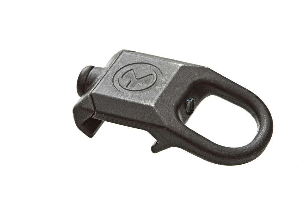

That led me to this, might be low profile enough to sit on the rail behind my sight, but I'll have to see where the balance point of the gun is...and think about the likelyhood of ripping the top rail off my gun by hanging it's weight on it:

i would not hang the gun by the top rail - that sounds like a really bad idea. there are usually tiny, short screws holding the rail on, and half that receiver is plastic. also, the side sling loop on that will put a lot of twist on your rail, making it even more likely to fail. that thing is likely designed more for integral rails than for light-duty bolt-ons.
Yeah, I know that's not what it's intended for. May be out of luck with the Mesa option as well. Pins appear to be of a smaller diameter than they are on my 870.
