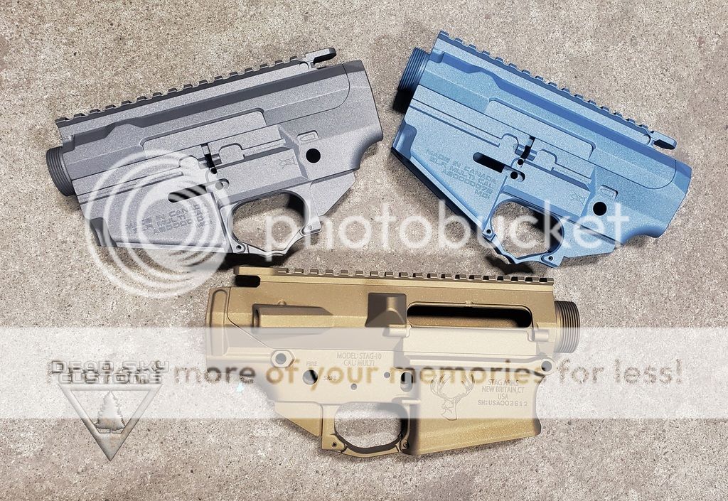

Here's a pic of two slr and a stag set. Will post pics once I rebuild.
