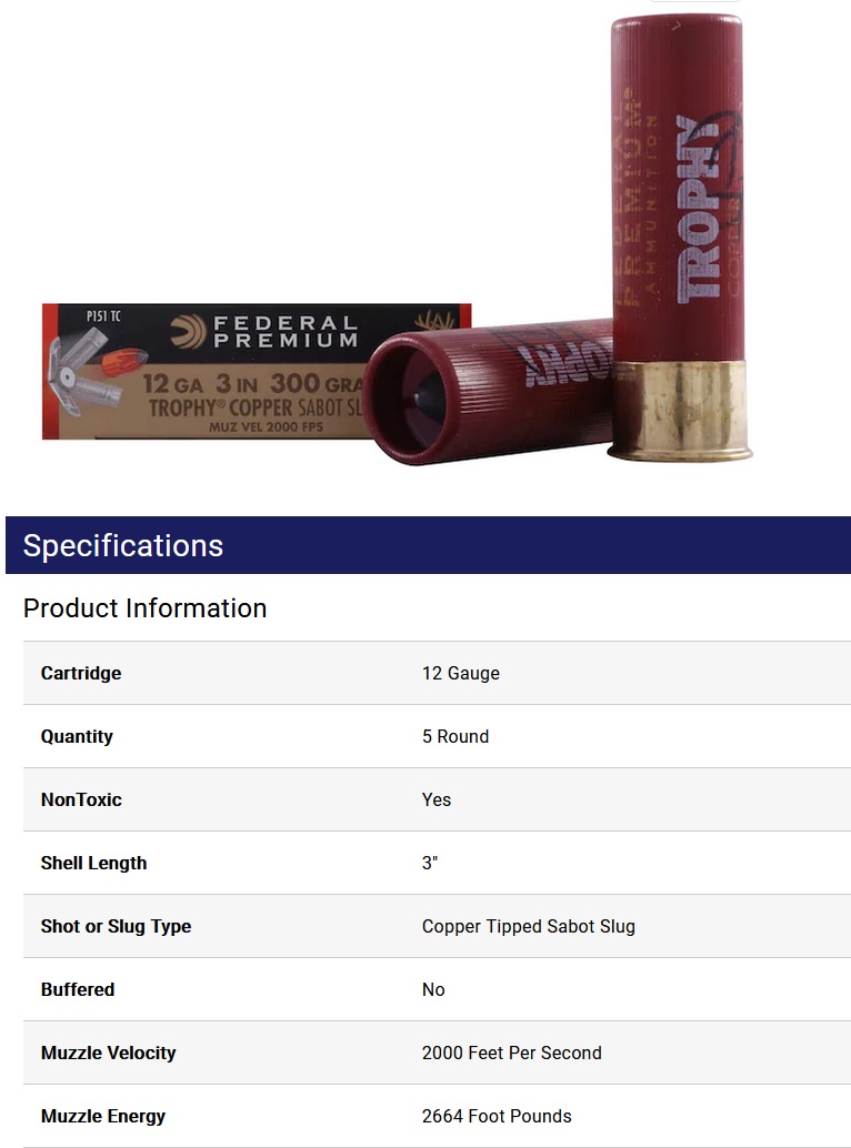

IMO, your looking at what I'd call 45-70Gov Trap-Door ammo. The pictured Federal 45-70Gov ammo is usable in 'all' 45-70's, Trap-Door's, Levers and Strong Action's(Ruger#1). So yes I'd agree, using Trap-Door ammo in the Marlin 1895 45-70Gov would leave you at a disadvantage.
When you compare comercial 45-70Gov Lever Action Ammo, like Buffalo Bore or Garrett, the 45-70Gov exceeds the typical* 12gauge. Buffalo Bore has 45-70Gov Lever ammo with ~3500ft-lbs of Muzzle Energy.
*The non-typical 12gauge load would be the Brenneke 656grain slug @ MV 1600fps & ME~3800ft-lbs.
