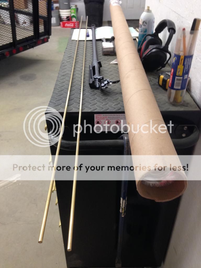

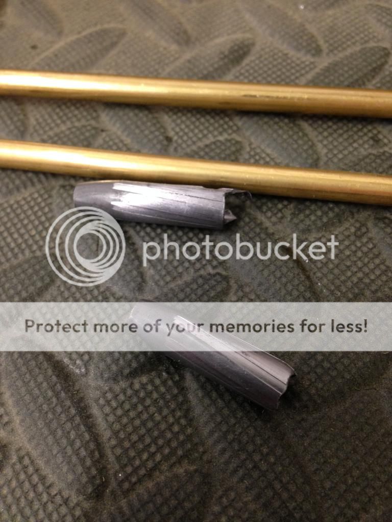

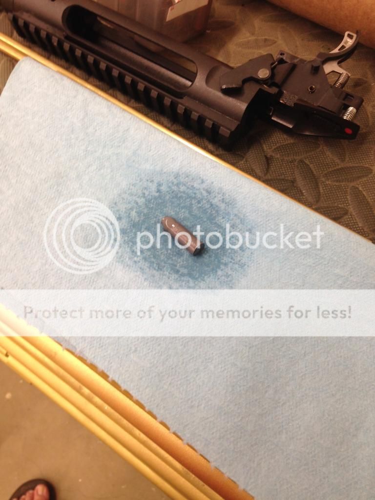

Finally recieved my brass rod so was able to slug my .338 barrel (yes the one that won't shoot). :rolleyes:
I did it twice tonight with the slugs donated by a very generous CGN'er who has watched my trials of this barrel.Thank you so much for the help.
What I found tonight:
Had to use hard faced hammer to start slug, soft faced wouldn't do , was tight for about 1/3 the way as it loosened I was able to push by hand another third, then it snugged up again which required the hammer once again, similar to my findings when I did it from the muzzle end.
This is just an FYI for those who were following my ladder tests and stress levels.
Felt so wrong to cut those new shiny rods!!!
