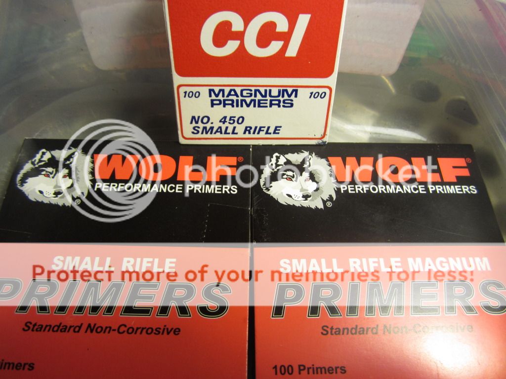

I decided to test the CCI 450 magnum small rifle and the two versions of the Wolf small rifle primer, standard and magnum.
To test the primers I fired them in a 38 Spl revolver (6” barrel) (no powder or bullet). I photographed the muzzle in a dark room, so I could compare the muzzle flash. This would be an indicator of the “hotness” of the primers.
As it turned out, I did not need the photos. The Wolf primers had a flash about one inch at the muzzle. I could see no difference in muzzle flash between the standard and the magnum Wolf. The CCI 450 (small rifle magnum) lit up the room. The flash was about a foot long.

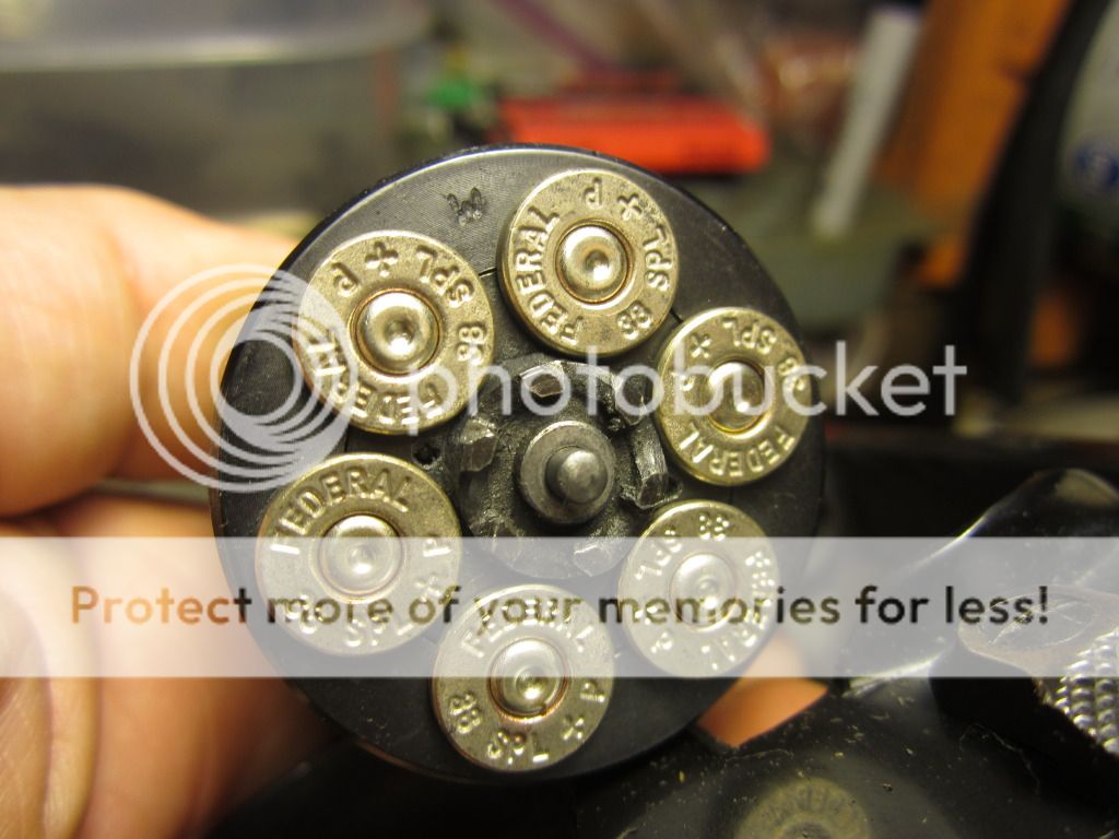

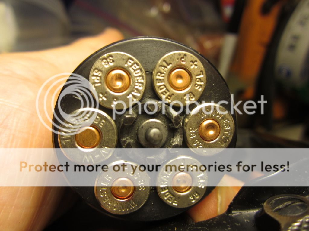

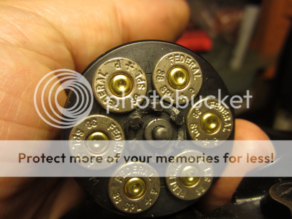

The Wolf primers are different colours, so it is easy to tell which was used in a given loading. The magnum is a light brass colour. The standard primer has a thicker, tougher cup and is a distinctive copper/pink colour. The CCI is nickeled.
Wolf Standard Small Rifle
Wolf Small Rifle Magnum
CCI 450
Conclusion: For my hard to ignite 223 CQB ammo, the CCI 450 looks best. For the Lapua 308 small primer Palma brass, the Wolf standard primer with the tougher cup looks best.
The only difference I can see in the two versions of Wold small rifle primer is that the standard primer has a harder cup, for military rifles with floating firing pins. The magnum has the same blast, but has a softer cup.
CCI 450
