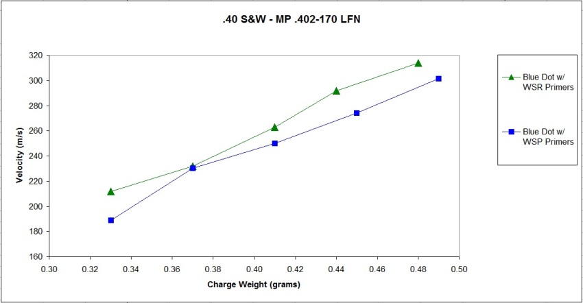

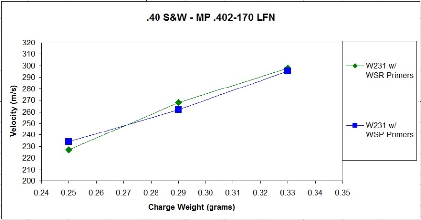

For the last two years I have been shooting small pistol a lot more and 5.56mm a lot less, so my primer supply was becoming SP-light and SR-heavy. I had seen some discussion on using small rifle for pistol applications, so a couple of weeks agao I loaded up some trial cartridges and the chronograph, and headed to the range.
.40 S&W data through a CZ75B. Please be careful with the units of measure.
The difference was less than I had guessed, only with Blue Dot did it look to exceed the margin of error. With Blue Dot the rifle primer increased velocity by 13.4m/s on average (about 44 fps).
