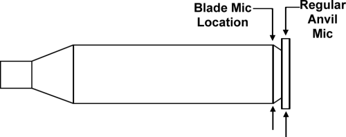

I ran into this problem myself when loading a 223 to the maximum. The primer I was using was piercing before the case began expanding at the head or reaching maximum pressure. How do you check maximum pressure without a laboratory pressure gun, you ask? To check maximum pressure on a given powder / bullet combination, measure the rim of the cartridge (at a specific point each time of the measurement) before and after firing. Cases don’t have to be new, just measured before and after firing.
[SIZE=+2]Discovering Maximum Load By Measuring Case Head Expansion[/SIZE]
[SIZE=-1]
[/SIZE]
This method works on bolt actions, but use with caution on falling blocks,like the Ruger #1, as there is no case head protruding from the barrel. In the falling block, the case is fully supported, allowing little expansion in extreme loads. When measuring the case head, readings must be accurately done in ten thousandths of an inch (.0001"). Don’t be afraid to check and double check your readings. If the case head grows more than .0001", you are overloading (going beyond the brass yield point) and eventually primer pockets will loosen up. A blade mike is nice, but a regular 0 - 1 mike in .0001" graduation is fine for measuring the rim. When using a blade mike, measure just above the extractor groove, in the same location every time. Use a scribed line as a marker. Take your time measuring. Do it twice to be sure, as .0001" is not much!
The trick to getting maximum, or at least knowing what maximum is, on your powder / bullet combination, is to reach maximum pressure (going beyond the elastic limit of the metal by only .0001" or .0002") and just back off 3 to 5%. It is best to work up loads in the hottest weather you’ll encounter while shooting. Hot weather means higher pressures (especially in the 90 degr. + temperatures). Be careful to work up in small increments when working with small cases, especially in 17’s. As a safety precaution, bolt action rifles should have liberal gas ports in their bolts, like the 98 Mauser or 77 Ruger. (See page 78 in the July 1992 issue of The Varmint Hunter Magazine on how to modify the 700 Remington for overload gas relief or see Gas Off Cure here.) Wear safety glasses.
