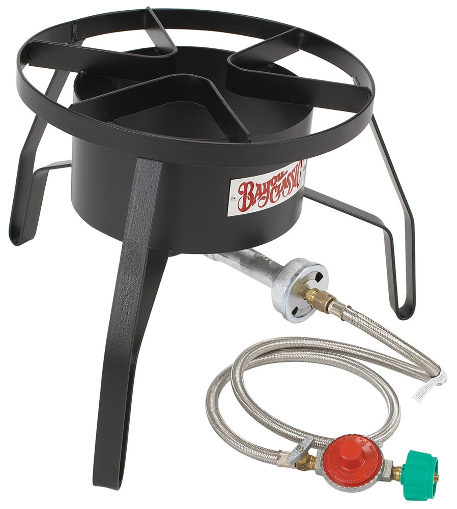

You need to get a gas "turkey burner" or electric hotplate and a thermometer.
Keep the temp around 700 and flux with saw dust to remove the impurities.
You can the also throw in a hunk of candle to put the tin back in the mix.
turkey fryer

looking at your first video, it seems pretty slow with the small cast iron pot your using. get a sturdy turkey fryer and make it even more sturdy, then cut a propane tank in half or near the top and you should be able to do 100+ lbs per melt. also add a sheet metal heat shield to focus the heat around the pot unless it's a perfectly calm day.

you certainly had a good yield all things considered, how many btu's is that propane heater? you could just rig something up so that's the burner in your make shift turkey fryer. the one i use is only 65,000 btu's
if you want to get real fancy you can make an even larger pot and built a spout to pour some lead from the bottom so you won't have to ladle it all. bigger batches mean more constant lead alloy.
