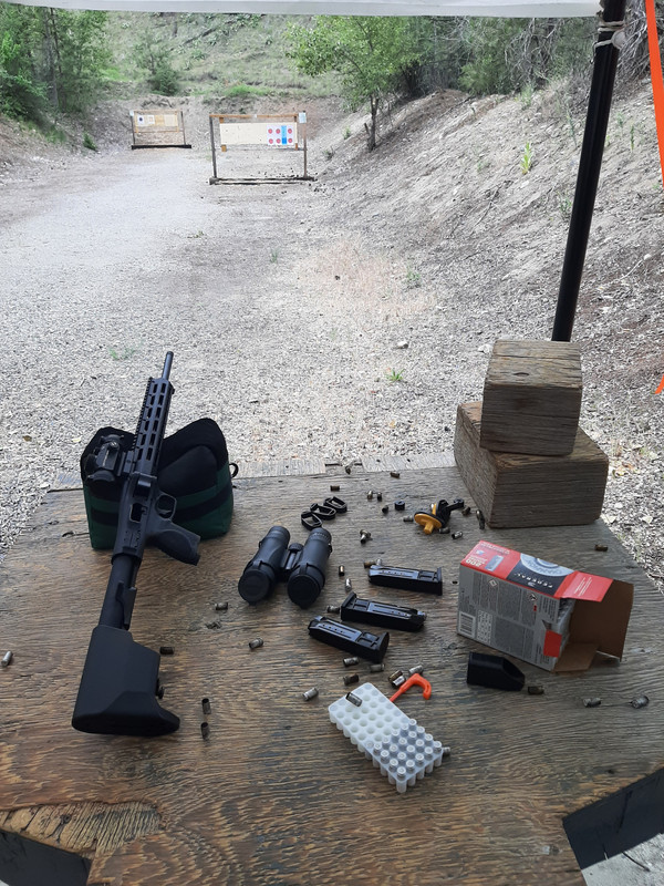

Finally made it out to the range with this new carbine, it was shot at 25m, 50m and 100m , using a Vortex Spitfire 1X, I'm happy with the results and accuracy for what this is. Everything was shot sitting with front bag used
I zeroed it with 124 grain Blazer brass, the rest of the day it was a mixture between 115 grain reloads and Federal 115 grain aluminum cased
Started out at 25m
Moved to 50m, circles are 3inch splatter targets

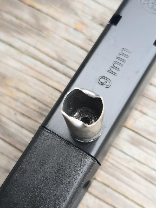

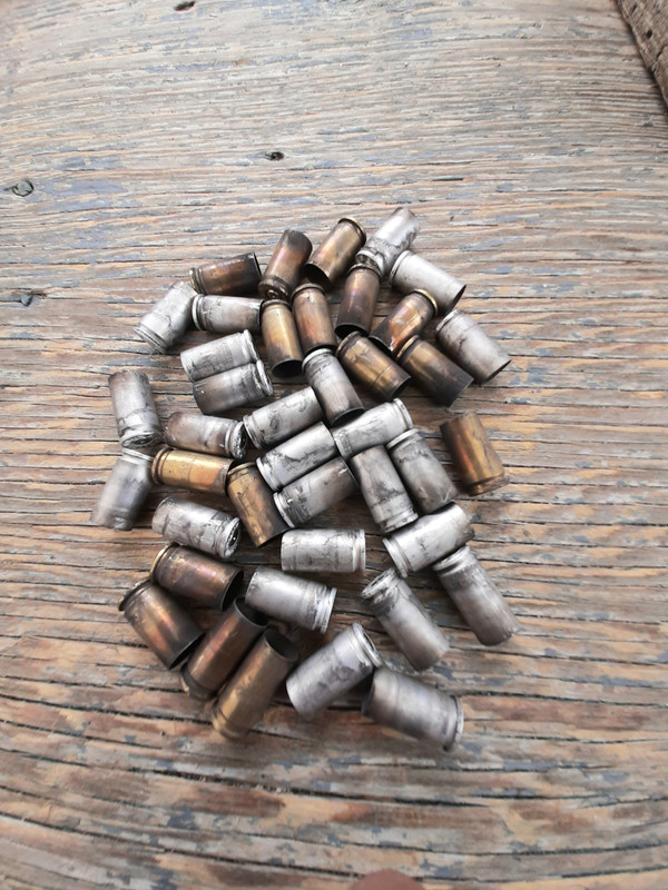

Had a FTE with the aluminum cased, 6th round fired on third mag
Moved out to 100m for the heck of it, circles are 7inch splatter targets, only was using a 1X Vortex Spitfire prism for the results speak for themselves

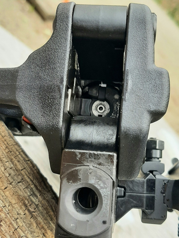

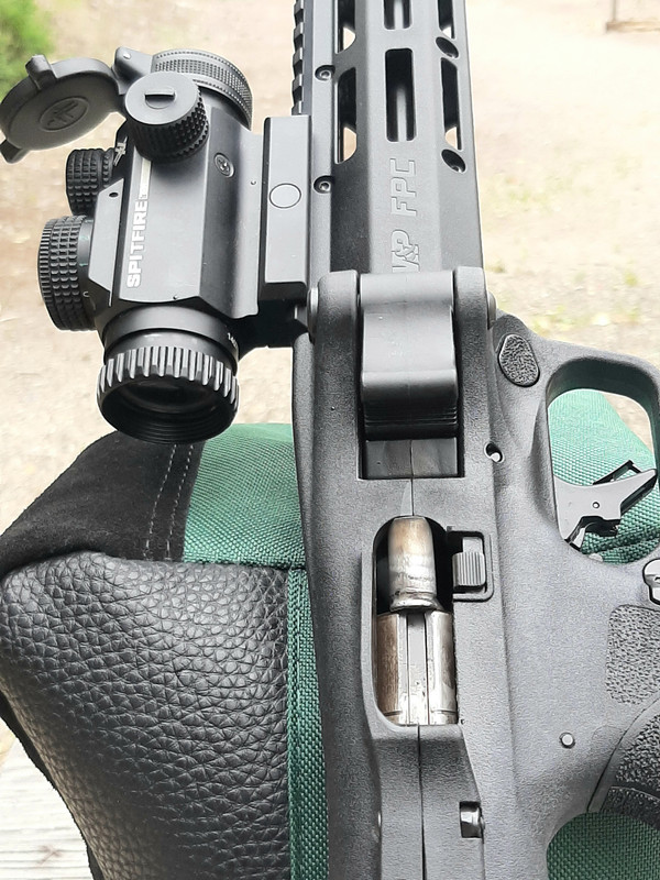

She's a dirty girl!

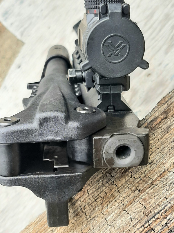

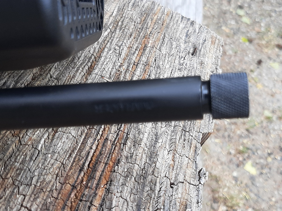

After about 200 rounds, I noticed the thread protector was about halfway off, make sure yours is tight

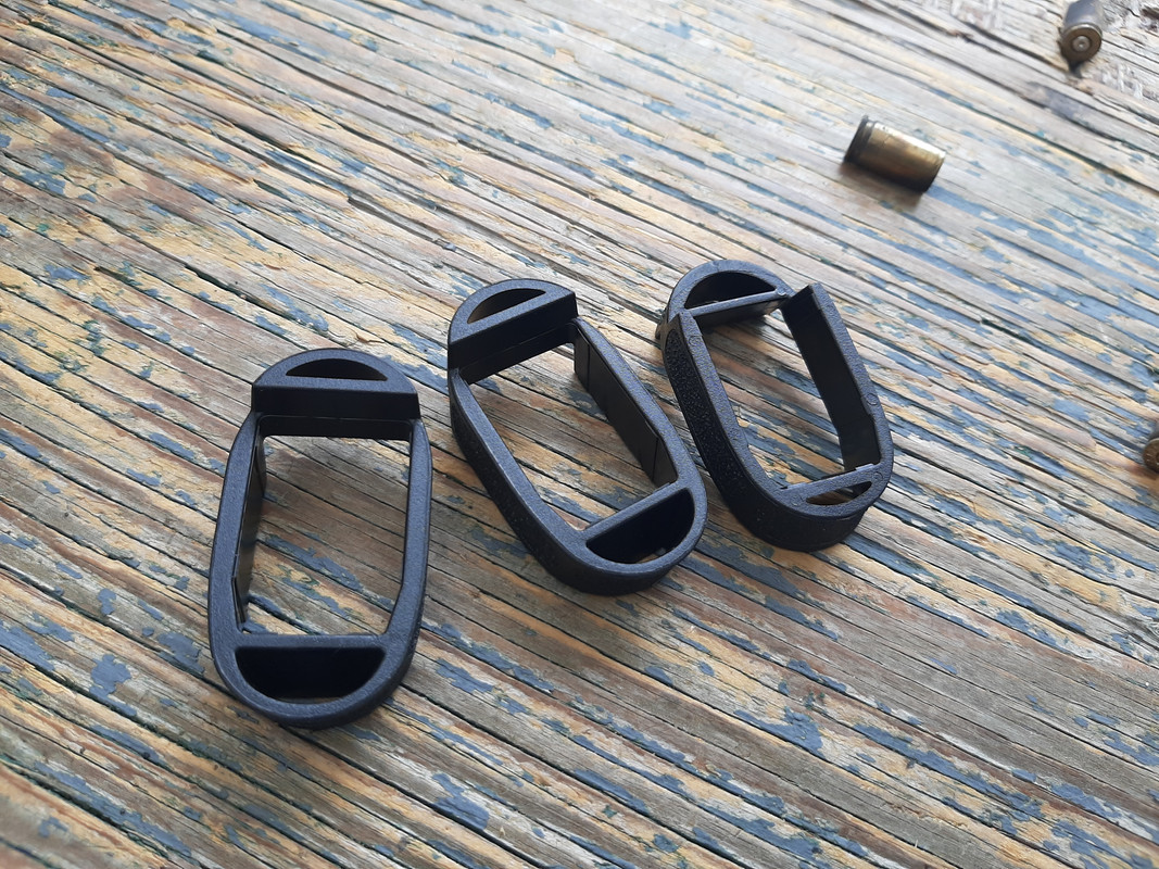

These are really annoying and get in the way, did not use them, would be nice to adhere them to the mag somehow

Appreciate the write-up! I really want one of these and you're just adding to the "pro" pile! I wonder how the FPC would fare with Barnaul steel-cased... probably not well after seeing the aluminum.
For the magazines, you'd probably do just fine ditching them altogether if you don't care about the look. If not, I'd try dabbing some super glue on the inside and on the bottom of the spacer (where-ever it contacts the inside of the magazine and the bottom of the baseplate), it should at least keep it from flopping around.

Your results look a lot the same as mine. I also had a FTE using alum cased ammo not one hiccup using brass.

Another note; I tried industrial grade super glue on the mag thingies, it dosn`t work, they all broke free after the first mag loading.
I'd imagine both the magazines and the spacers would have mold release agent on them. The right kind of adhesive should have no problem with the plastic.
...For the magazines, you'd probably do just fine ditching them altogether...
You might get problems with over-insertion if you don't use the spacers. I recall at least one video reviewer having the issue.

- the barrel thread protector unscrews on its own.

What are the mag thingies used for?
The grip length of the FPC is short so that you can use M&P Compact magazines. The spacers take up the extra length of the standard M&P magazines. They give a continuous gripping surface all the way down to the mag floorplate. You can use the gun without them, but there is the risk of over-inserting the magazine.
Thanks for the explanation. In that case would a dab of silicone on each side of the mag anchor the spacer OK? If the clearance between the spacer and mag body is reasonably small silicone should be enough and you can cut it to remove the spacer if needed.

Range day report. I fired 100 rounds of Barnault Steel cases and all went well.

If you have a friend in the US order some Compact base plates. All the 10 rd mags for the FS and Compact have the same metal portion. The only difference is the length of the plastic base. The plastic bases are not that expensive. You will end up with a Compact grip which for my Medium Large glove sized hands work using the Compact Pistol. When I got my Compact I got one Compact Mag and two FS mags with those spacers. I know have five FS Mags wearing the Compact base which gives me a flush fit on my Compact pistol.
