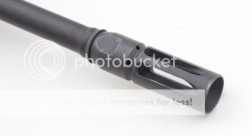

The flash hider is also a unique design--it's both a compensator and flash hider. It's a bit long-ish for me, but I'll see how it performs. I find it, along with the Magpul MOE fore-end, lend kind of an FN-FAL look to the rifle.

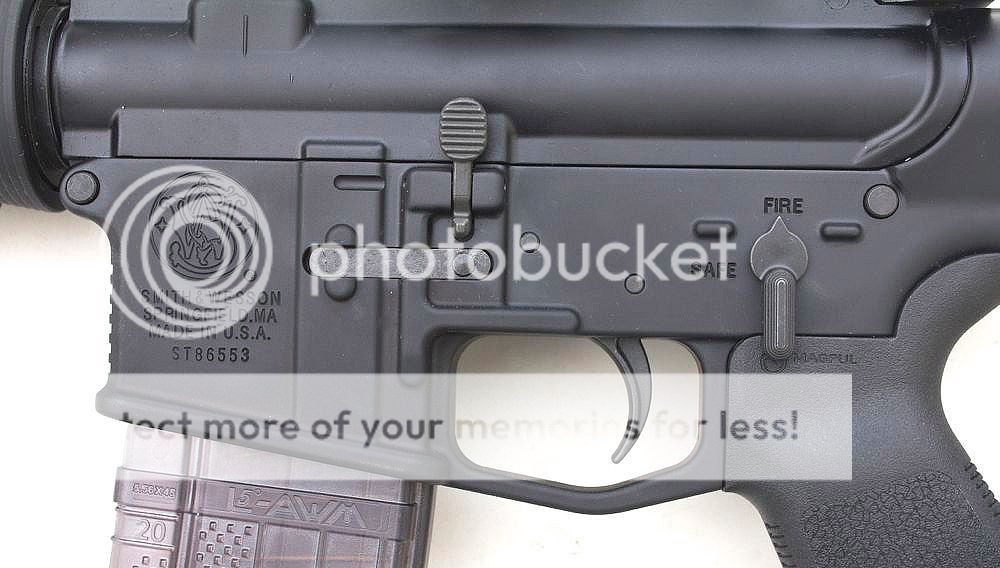

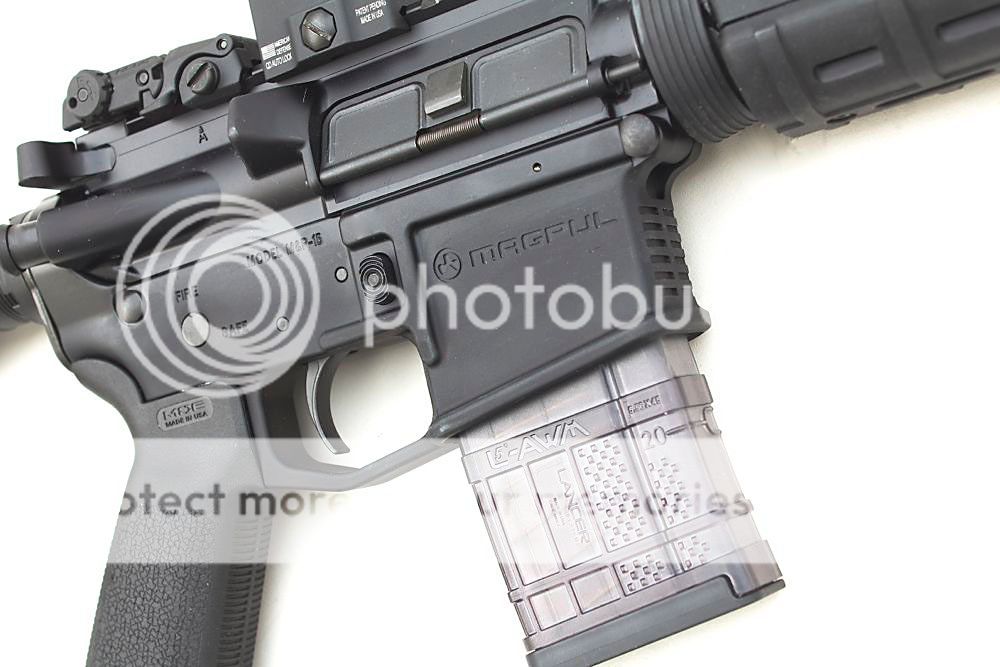

The lower receiver is unique as well. It's forged, and has a flared magwell. The front is textured for, I guess, shooters that like a magwell hold. There's a nicely-shaped integrated trigger guard, and a "finger shelf", apparently intended to provide "increased ergonomic indexing of trigger finger." Shooters that use Magpul's BAD Lever are out of luck as it does not fit.

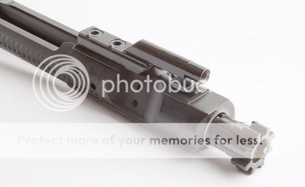

The bolt carrier has adequate, but not the best I've seen, staking on the gas key and is chrome-lined, apparently.
