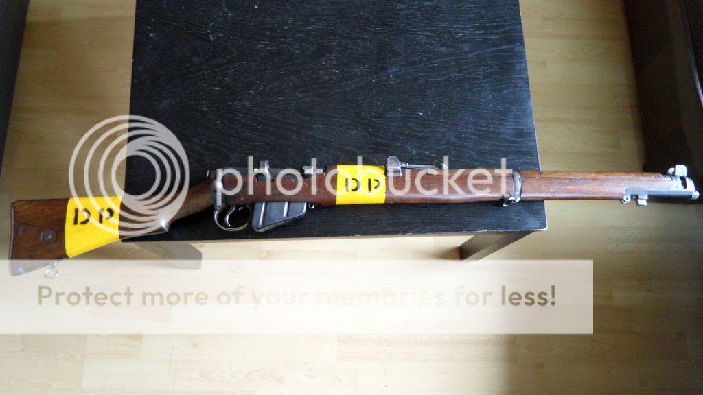

A friend brought this rifle over to do some shooting yesterday. He wanted to know more about it other than that his father had bought it when he was a boy and had a gunsmith go over it and install a firing pin. My knowledge being very limited, I told him that at some point it had been downgraded from service to drill purposes and I could see it was stamped 1915 on the band. I assume it is British made. He was wondering if it held and value other than an average sub $200 sporter as we both enjoyed shooting it just as it is. I haven't a clue. I do find the single shot ramp interesting and the peep is cool. These are only cell pics but maybe someone has some identification input? Thank you.

1915 no.1 mk 3, has the rear part of the volley sights, the front would attach to the dial on the left front forearm. Also have the mag cutoff, and windage adjustable rear sight. Would be a nice restore project. Canyou get some better pics of the wrist an maybe serial number prefix for further id
Butt stock is DP marked for "Drill purpose", usually for rifles that were deemed not fit for regular service anymore but not always. Does this marking appear any where on the receiver ?
She is a definitely a restoration project as she is the first SMLE sporter I have seen with any remnants of the volley sights intact.
The rifle is DP marked stocks and steel. It was deemed fit by a gunsmith and shoots decent enough. I'm guessing the rifling was deemed worn but it does not keyhole bullets and only a guess. I will try to get some better pics of the SN and wrist tomorrow. Thank you very much.

Well if the metal is stamped DP here and there, (which I can't see if it's the case or not from the pictures), I would be reluctant to use it. A butt stock, on the other hand, isn't enough to certify the rifle as genuine "DP".
As Nabs mentioned, a real No1Mk3 (NO star) is not super common, and worth de-sporterizing. If it's also good to shoot (in my opinion). Yours seemed to have been dipped in Tremclad paint at some point, but that's easily stripped away. Finding the parts is also a challenge but possible.
I think it could be worth posting these pics on milsurps.com and see what a few Brittish colleagues could come up with (maybe even Mr. Laidler could chime in!)

Lou, you can see the DP in the 7th pic, Scamaniac also said "The rifle is DP marked stocks and steel."
If i was to waste any money on a DP'd rifle, i would do it up like this.
Google searched photo, not my rifle.
you can see a DP stamped on top of the action, not worth restoring unless you don't value your hands/face/etc
Perhaps not a good candidate to restore as a shooter - but restoring it as a representative specimen of the pattern of rifle used in the first half of the Great War would make sense. Having the cutoff, rear long range sight and the plate for the long range front sight is helpful.
The only official reuse of DP receivers in functional rifles that I can think of is in the production of Delisle carbines.
I likely won't get a chance for any more pictures this week as the owner and I are on opposite shifts this week. I can't imagine him doing a restore himself, but I will run it past him. I will also pass along the warnings about the DP and suggest he maybe get it checked again by another gunsmith since his father had it done last when the firing pin was repaired years ago. From what I've read about the downgrading to DP, it happened for a lot of different reasons, that varied by the era, and the country. Did the armories xray the steel or have any technology that today's gunsmith does not? I am puzzled as to why someone would sport a DP rifle? After looking this rifle over I would guess it got the DP because it was old, worn, and had a broken firing pin. Spent brass looks perfect but maybe I should have been wearing a welding helmet instead of safety glasses. Thanks very much for everyone's help.
That thing is a wall hanger. Buy another sported rifle that is NOT DP. $200 is damned cheap insurance to ensure you dont lose a hand or an eye. But maybe I am crazy.

It would be interesting to find out what the bore looks like, and what it slugs at. And what kind of shape the chamber is in. I am guessing that a rifle would receive a ZF or ZF-BER because of a bad receiver rather than simply a bad barrel. My 1915 has a 1944 barrel on it, and I know it was commonplace to replace barrels if the receiver was still good. But those receivers lengthened with use. In any case, there are some good parts on that rifle.
Rifles got DP'd for all kinds of reasons. Not all of 'em were because the rifle was unsafe to shoot.
Anyway, you have a regular sporterised No. 1 Mk III Lee-Enfield. Your's is unusual because it still has the magazine cut off. That was there because the Generals, at the beginning of W.W. I still thought in terms of Napoleonic battles(the PBI breaks the enemy's line and the Cavalry rushes through the gap.) and they thought the troopies would waste ammo. Single shot firing only unless you're told otherwise. Doesn't add or detract from the relatively low value of your rifle. Lower than the same rifle in full military configuration.
The so-called 'volley sights' is grenade launch sight. A lot of rifles declared to be not worth fixing got made into grenade launchers. The large disk on the stock is the base for a grenade launch sight. Mind you, most of those have the wire wrapping on the forestock.
The regular front sight was used for "volley fire". Rifles were used as mini-artillery during W.W. I. The whole Regm't set their sights to whatever distance was required and everybody fired at once. This was done with MG's too.
Find out of the smithy checked the headspace, if you can. All Lee-Enfield rifling looks worn. It may or may not be, but it's all shallow. Slug the barrel by hammering a cast .30 calibre bullet or suitably size lead fishing sinker through the barrel with a 1/4" brass rod and a plastic mallet then measuring it with a micrometer. Lee-Enfield barrels can measure between .311" and .315" and still be considered ok. Over .315" the barrel is shot out.
The blotchy finish is worn off paint.
