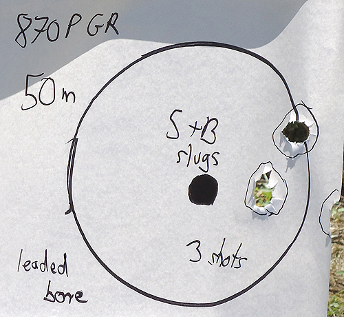

  1. Groups did open up with a leaded barrel and after around 20 to 30 slugs through the barrel.
  2. I got random flyers with a leaded barrel.
  3. And point of aim shifted. Now, I am not 100% sure that this was due to the leading, or if this is due to my setup. My rear ghost ring is fixed to the receiver, and my front sight is fixed to the barrel … and there is around a 1mm wiggle between the barrel and the receiver and until I screw the magazine cap tight. So, when i take the barrel off the gun ... and put it back, there is a chance that the point of impact has shifted slightly.

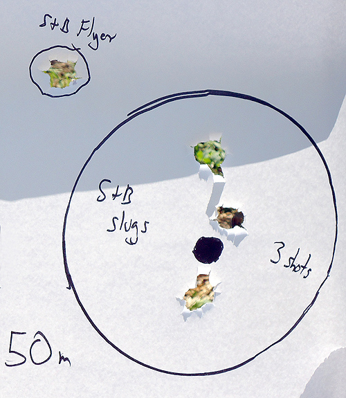

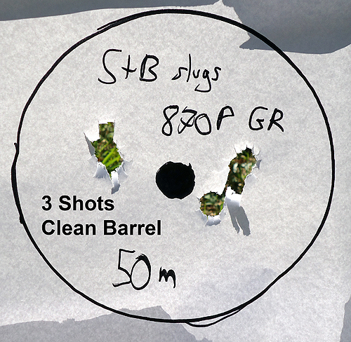

I started out with a clean barrel and got a groups like this .....

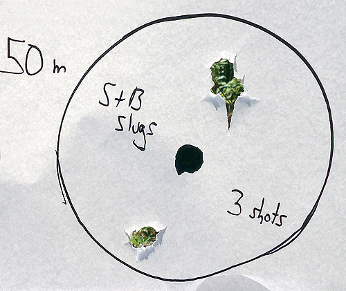

Down the road and with a leaded barrel I got some random flyers …

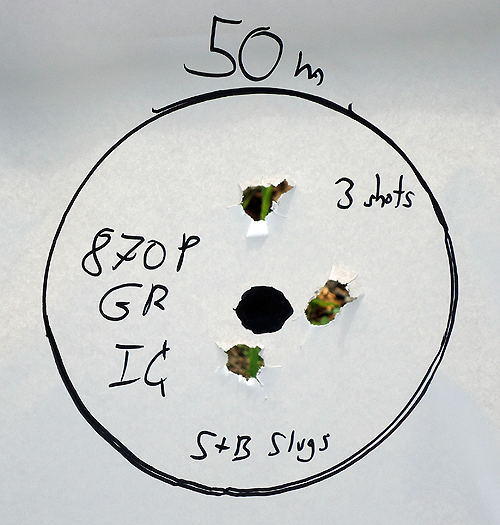

Point of impact shifted ….
Groups opened up …
And after a long long long cleaning session … I was getting this again ....
Voila ....
