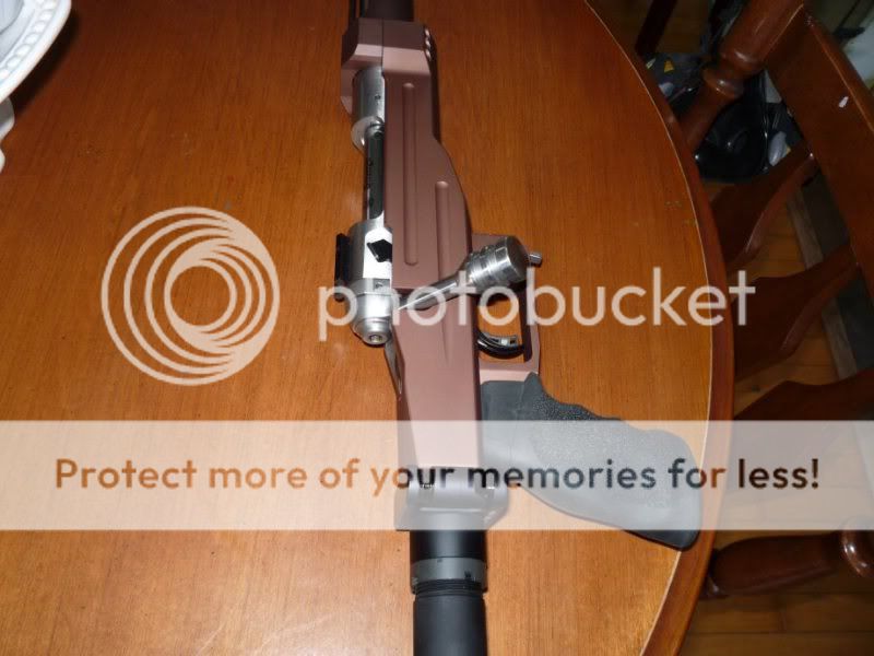

Here are a couple of styles of savage knobs I have made. Very easy for the do it yourselfer too BTW. I'd be happy to help out with instruction on doing it.

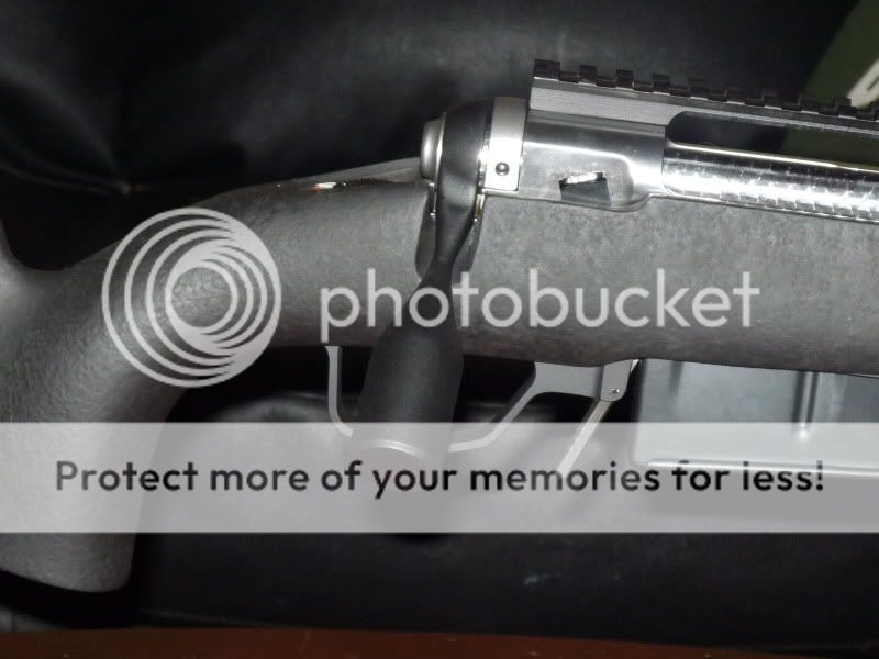

Would it be possible to thread a SS varmint bolt handle (the big knob) in order to accept an aluminum knob? I' like to shave 2oz off my bolt handle.
