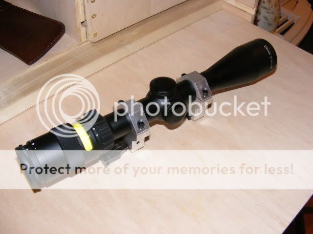

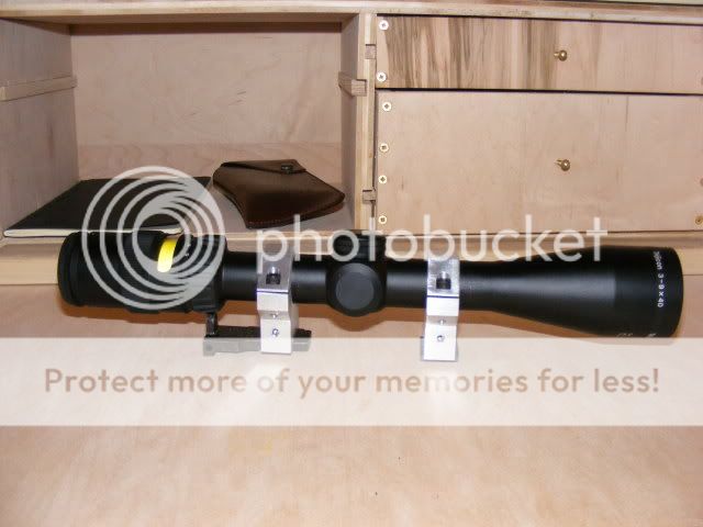

I did a little project today with help from one of our Tool Makers at work, anyways, I had bought a pair of old Parker Hale scope bases for the Lee-Enfield, but they use a single dovetail that is not standard to any but their own.
I couldn't find rings, so I made a matched set:

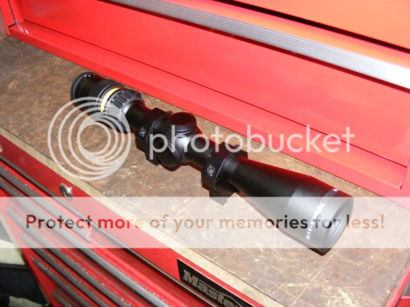

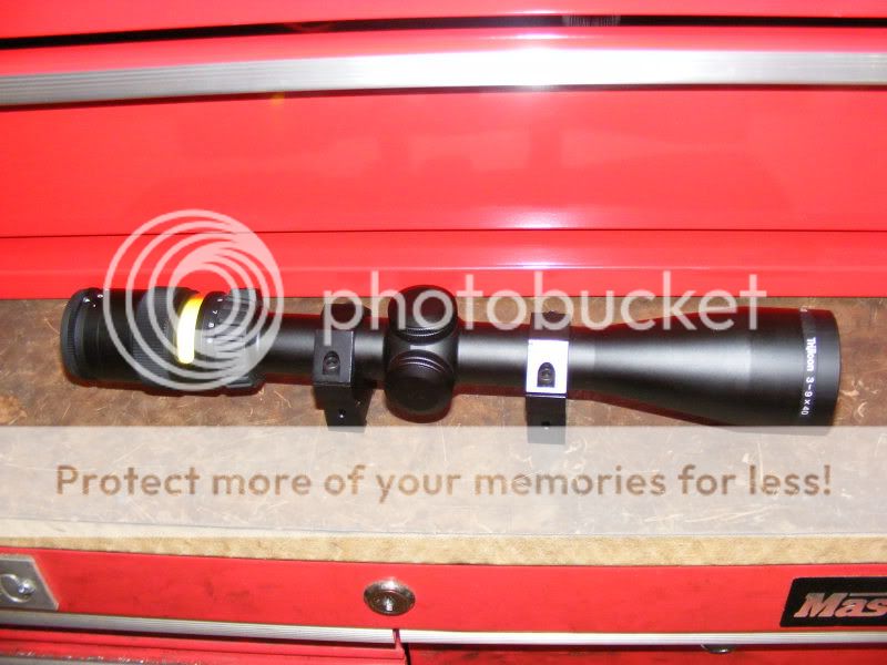

I think I'll send them out for Hard Type III Anodizing however. They look a little plain as they are right now. :)
What you think? :D
Dimitri
Very nice, how do they fit the scope, nice and snug?
Like a Glove, the bore is only .002" over sized from nominal (so 1.002")

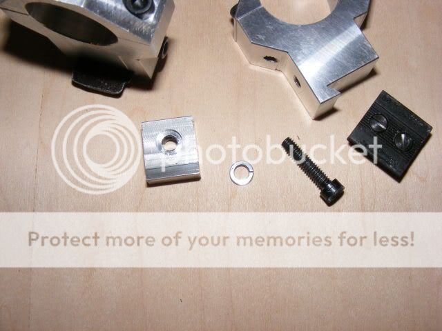

One thing I forgot is that since we all know how annoying it is to have a scope ring get lose from the mount I machined a counter bore on the clamping side to accept a #8 lock washer about .005" shallow giving the lock washer the final clamp down so it doesn't vibrate lose.
