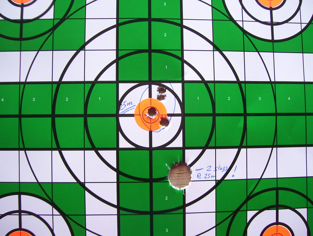

This target shows a mix of shot fired through a 2010 Brno 802 Combination gun in 12 gauge (3") with Improved Modified (IM) choke OVER 30-06 Springfield at 25 metres. No scope, just the good old fashioned iron sights.
Ammo used:
Remington Express 30-06 180 Grain Core-Lokt Pointed SP, Muzzle Velocity: 2913 fps
Winchester Rackmaster Rifled Slug, 12 gauge, 3 inch, 1 1/8 oz, Muzzle Velocity: 1700 fps
Four 30-06 rounds were fired from 25 metres in the sitting, freehand position. They are tightly grouped around the bullseye (about 1 inch). The first shot of the four was fired from a cold barrel and nailed the bullseye dead on! In truth, I can probably improve on this grouping even more.
2 rifled slugs were fired from 25 metres in the sitting, freehand position -- both in the same hole! These are the 4th and 5th slugs ever fired from this gun. I have little doubt these could drop any deer within 100 metres if I scoped it.
So, with a combination gun, you have the best of both worlds, and Brno's are hard to beat for accuracy.
The sights are clearly factory adjusted for the rifled barrel, with the shotgun barrel shooting slightly lower.
