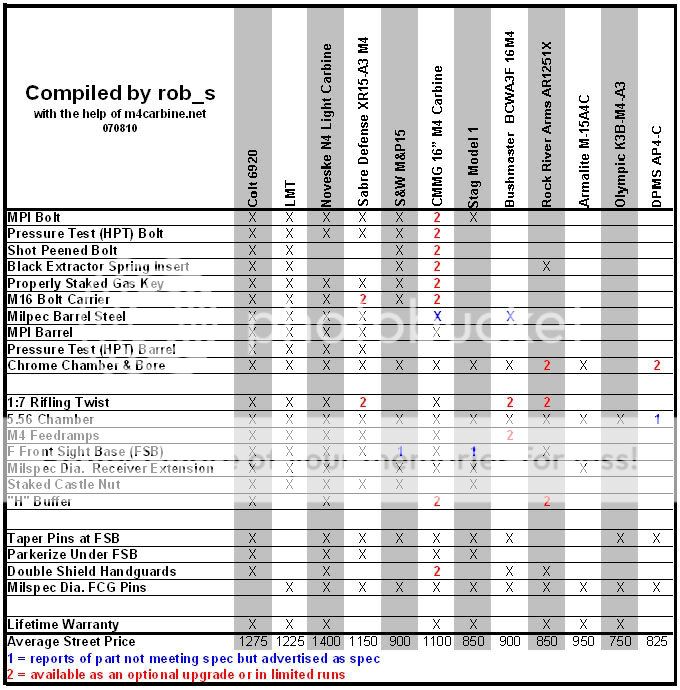

Actually that list I believe was for those looking to buy a mil spec'd AR which has certain criteria like chomed M16 chamber and lined barrel. There are near 20 different criteria to look for and the closest to genuine mil spec was the Colt (older or those with chome lined barrels as Colt no longer does this on all rifles) or Bushmaster (I called Bushmaster and asked them about the following chart, I should know more soon I hope). Not saying one is inherently better than the other just what is closest to spec. None of the civillian models covered everything, I believe the Colt's flaw was non-standard trigger group pins. The rest are further away but everything is subjective. If you don't care for a mil spec'd AR, get your own preference. Just remember, I got all my information from the internet and not from Colt, Bushmaster or the US Army so take everything with a grain of salt. Just make sure you're happy with what you buy and what you pay and you'll be golden.
Found the chart
http://www.m4carbine.net/showthread.php?t=6642
