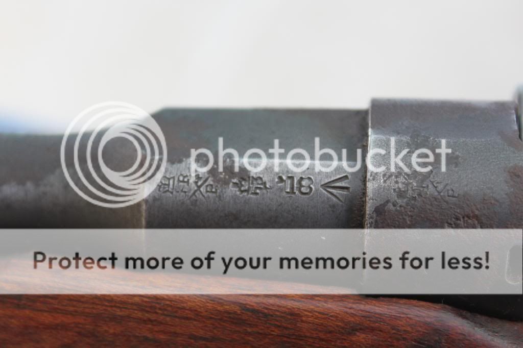

18 broad arrow stamped on barrel.

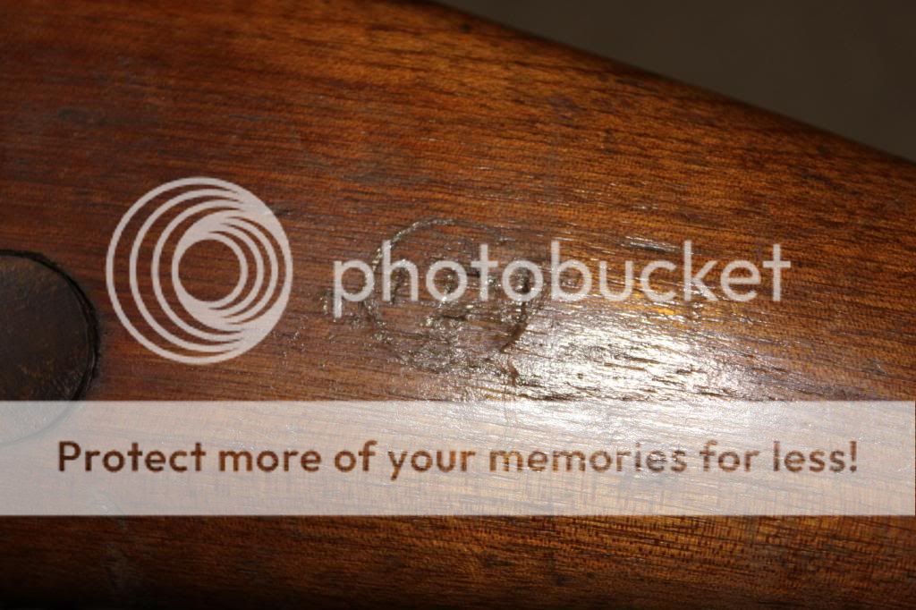

Stamp on butt - L arrow A or I arrow A in a circle.

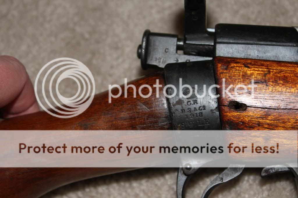

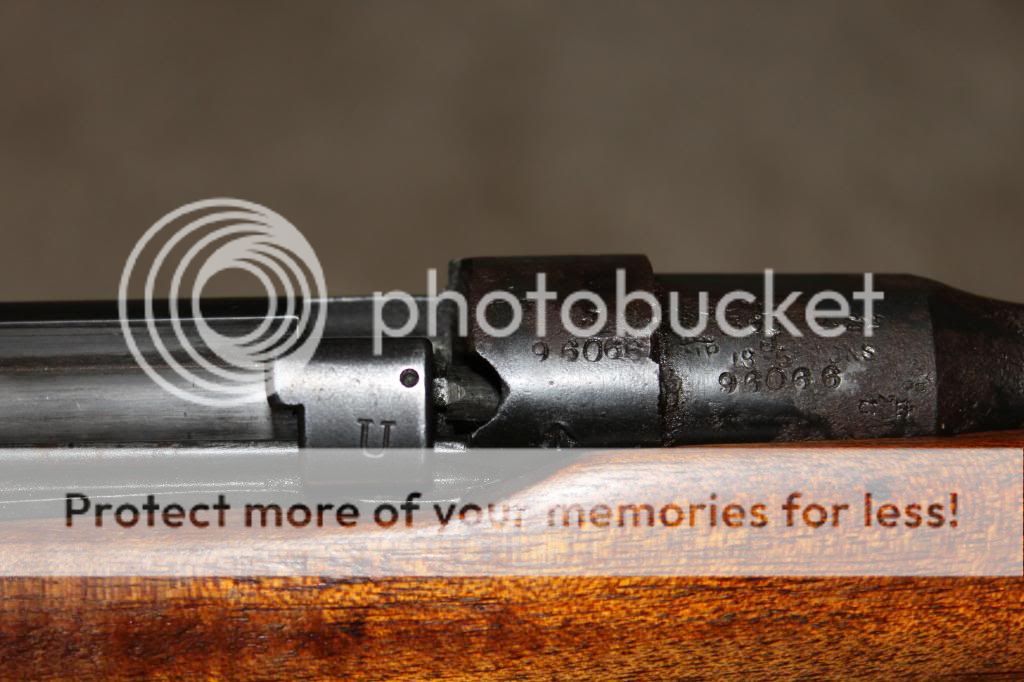

A few more pictures.
Other side of the barrel:

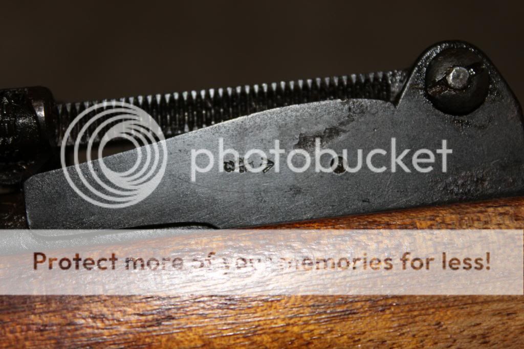

Side of rear sight:
Another shot of the stamp on the butt stock - I still think it says I↑A.

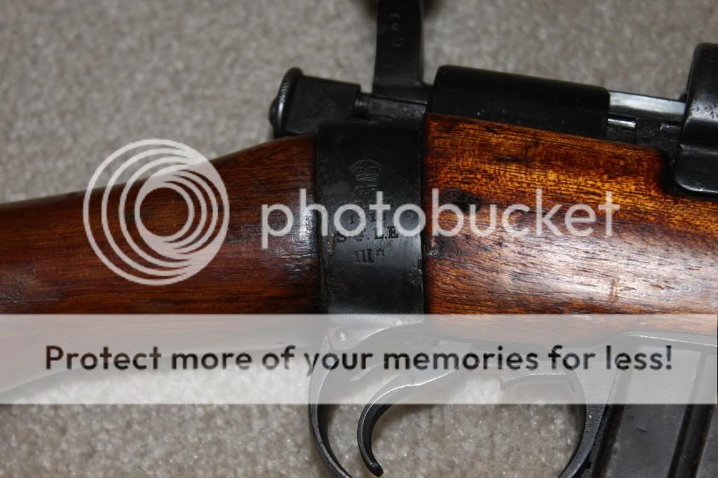

Right side of Socket:
