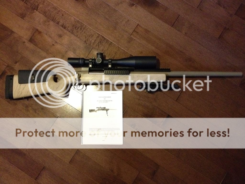

My attempt at a Mk13 Mod0, but it needs a rattle can camo job to look authentic!
-700 Long Action
27" 1-9 twist Krieger
300 Win Mag with A191 Chamber
M16 extractor on fitted PTG bolt ( Speedlock (sako) was correct and some had std Remington extractors as well)
Mcmillan A2
McCann MIRS mount,
NF 5.5-22 x 56
I picked up the proper NSWC Crane recoil lug after it was built so that will go on at the next re-barrel

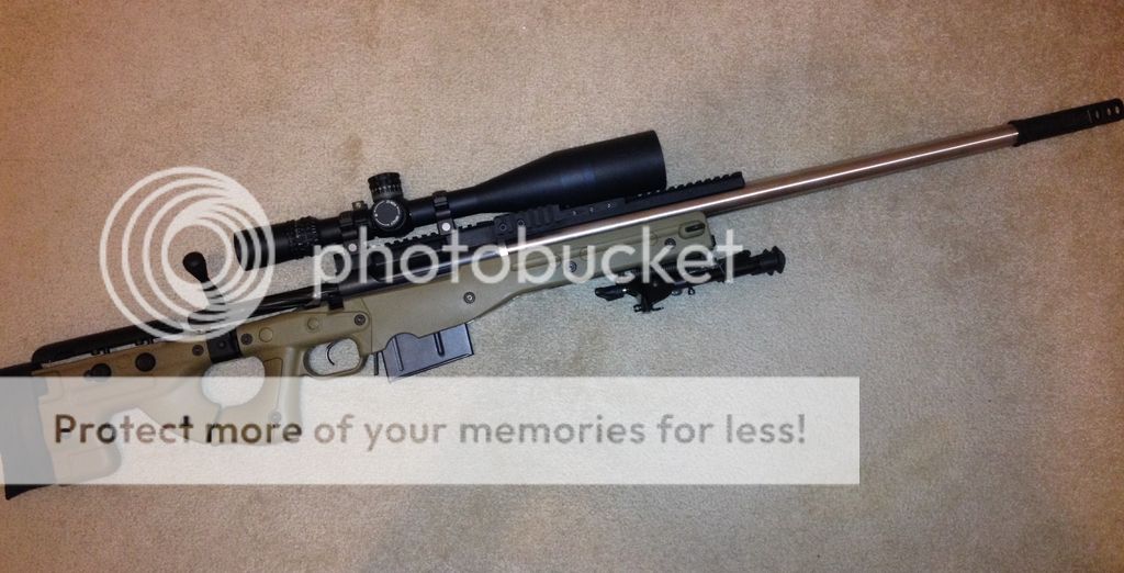

And then a Mk13 Mod5 inspired build, but with a Stiller Tac338 action,
AICS Chassis (need to find some old style retro FDE skins)
Krieger 1-9.35, 338 Lapua Mag
Surefire brake
Remington MARS rail cnc'd to fit the Stiller action
NF 5.5- 22 x 56
