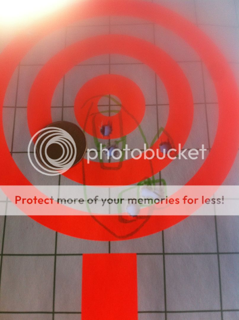

Thanks for all the help, I found my swivel stud was pressing the barrel ( who ever recommended checking that thank you ) and swapped to 130 grain along with a .30 cal bore snake cleaning. Much better, Brought my 6 shot group down to 1.7"
I was using a box of 150g federal premium ( turns out it was regular federal ), at first i got it down to 2-3 inch groups. I then put up a new target and got 3 in 2 inch group followed by one off the paper and one 6 inchs off to the corner by the 20th round... Why am I getting there crazy outliers, There is no way I missed the paper completely due to my own error.
I have a Leopold scope mounted to the .270
UPDATED PIC - Cleaned and used my backpack as a rest, this is at 100 yards. Nothing to far out now. Still not grouping like I hoped, 3.3 inch grouping. May try 130 grain.
