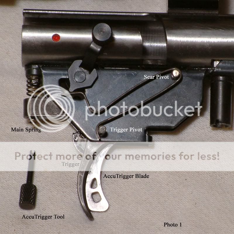

Picture from RFC.

I just got a savage .17hmr mako "the shark looking one" and supposedly can can reduced or increase the trigger pull quite easy how would one go about doing this ?.

How to adjust about 1 minute in... pretty simple just pull out of the stock.

All accutriggers are adjusted the same way. You can even go a step further and do a trigger job ht tp://www.rimfirecentral.com/forums/showthread.php?t=227014
If you dont have the tool, just take a nail, cut off one end and then cut a slot in that end.
