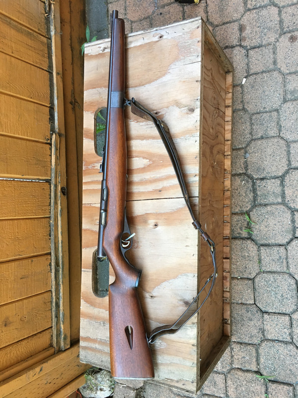

Whats on the bottom of the pistol grip on the Mossberg? It could be a Speigel model. Is the receiver drilled and tapped? Brno is nice too.
It’s a screw driver. Optical illusion. Yes it’s drilled and tapped with screws in place. So maybe a spiegel. Don’t know more than I’ve research lately. Which isn’t much. Cheers

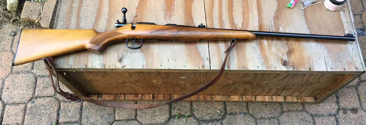

Thanks for the information. They are very interesting little rifles. I will treat it well and feed it a diet of soft food. It needs some parts but looks useable, with a decent bore. Does anyone know if the Mossberg model 51 has a bolt hold back lock? I can’t seem to lock it open. The safety on the BRNO Model 5, I cant quite figure that out either. It looks like you push it forward but it sure doesn’t feel like it wants to. It might be different with a round in it but I’m not sure. I’m also looking for metal magazines of this vintage Brno in ten round. Any info would be appreciated. Thanks again

The Brno safety should push forward when cocked.I don't think it will move if uncocked or fired. I don't have my M51 in front of me but I don't think it does have a hold open. If it does you would pull the bolt back and push the cocking handle in.
Thanks. What type of Ammo is needed to cycle the Mossberg? It’s just a hair younger than me and I’m pretty weak these days. I’ll start on the soft side til I get it to cycle. The Brno looks new so I would think it can take most Ammo but again I’ll see what it likes and start at standard velocities.

That's how my 151 works, but looking at OP's pictures it doesn't appear that the 51 has the same setup.

Not exactly the same, but my 151 runs happily on 525 pack Federal or Dynapoint GT bulk ammo as well as a couple standard velocity choices I tried.

The M51 also known as a flatback is an older model and the end cap on the receivers don't have a heavy thread. I wouldn't use anything high velocity for fear of blowing the cap off. Use only standard velocity in that one. the Brno will shoot pretty much anything. CCI Blazers or the 525/333/222's are usually a good place to start if you want to do some plinkin.

Good advice. It is the flat back and I’d agree that the threads aren’t very robust. The flip
up front ghost ring is very neat too. The Brno came with a weaver b4 scope that I can hardly see through but it looks the part. Thanks again
Try western gun parts in Edmonton for the mags, I have 10 rd mag for the norinco JW15 that works in the Bruno's., but I don't know of a supplier for them.
