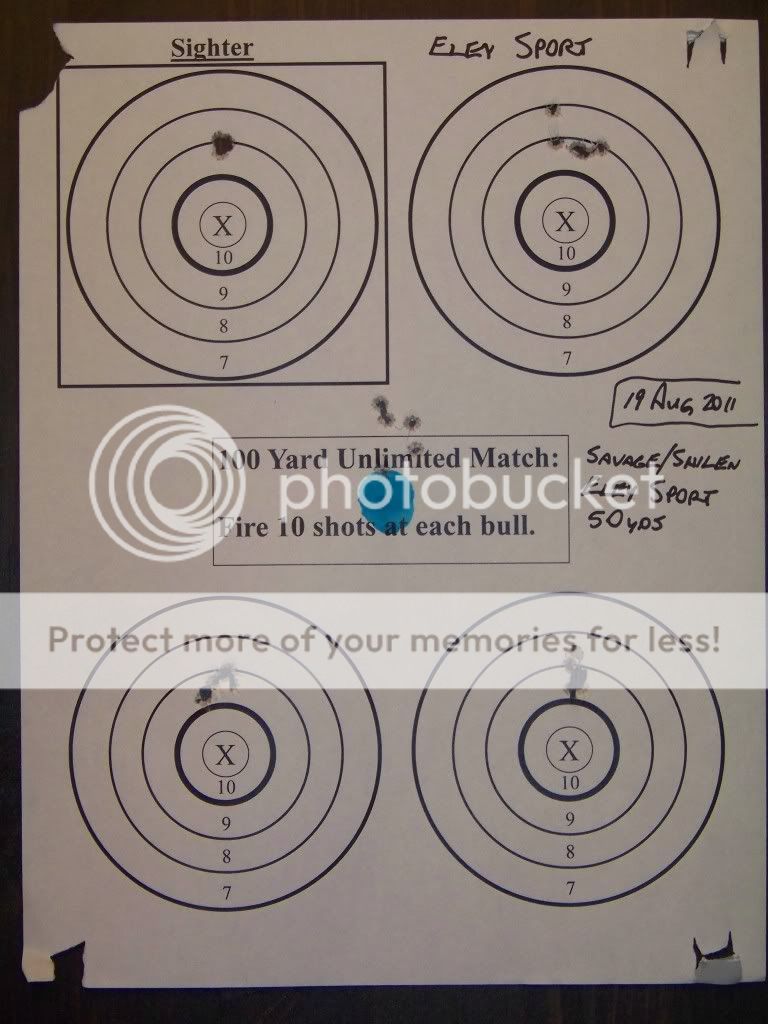

What are you using for ammo? I have found that Eley Sport is the best so far in my rifle. I have a couple of other ones to try if the weather ever settles back down here.
Below is a pic of my test groups with the Eley, 5 groups of 5 rounds each at 50yds. The center group was the fouler and I pulled the one flier out of the group at the top right. The one hole group top left was awesome, I saw the trace on 3 of the 5 rounds, all going in the same hole. Wish I could do that every time...
Mark

Mark, give SK rifle match a try. I quite using Eley sport cause of all the flyers it produced. Some of those outs are not your fault. The groups look a whole lot like mine. Super tight, then really generous, then a zinger off in la la land.
Shoot it at 100yds and it is hilarious.
I found SK to be very stable with little vertical dispersion and so much more consistent. Some 100yds 5 rds groups.
