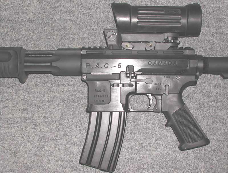

Here is a pic of the "new" DAR701 series AR15 clone:
Looks very Buck Rogers. Not that there't anything wrong with that, except here is the ad copy:
Now take a moment to digest the text I bolded in the Ad copy. The quad rail forearm is FREE FLOATED. Now look at the Sight Rail. It seems it's bolted to the upper's piccatinny rail AND bolted to the front gas block.
I'm just a lowly Mechanical Engineer, but it would seem to me that using that sight rib would rigidly connect the tip of the barrel to the upper, which is exactly the condition that a free floated forearm is supposed to circumvent, right?

By the way, it would look WAY better with a magpul stock to compliment the "starwarsian" lower receiver.

# Free-floating aluminum picatinny hand guard

# Sight rail as shown not included
