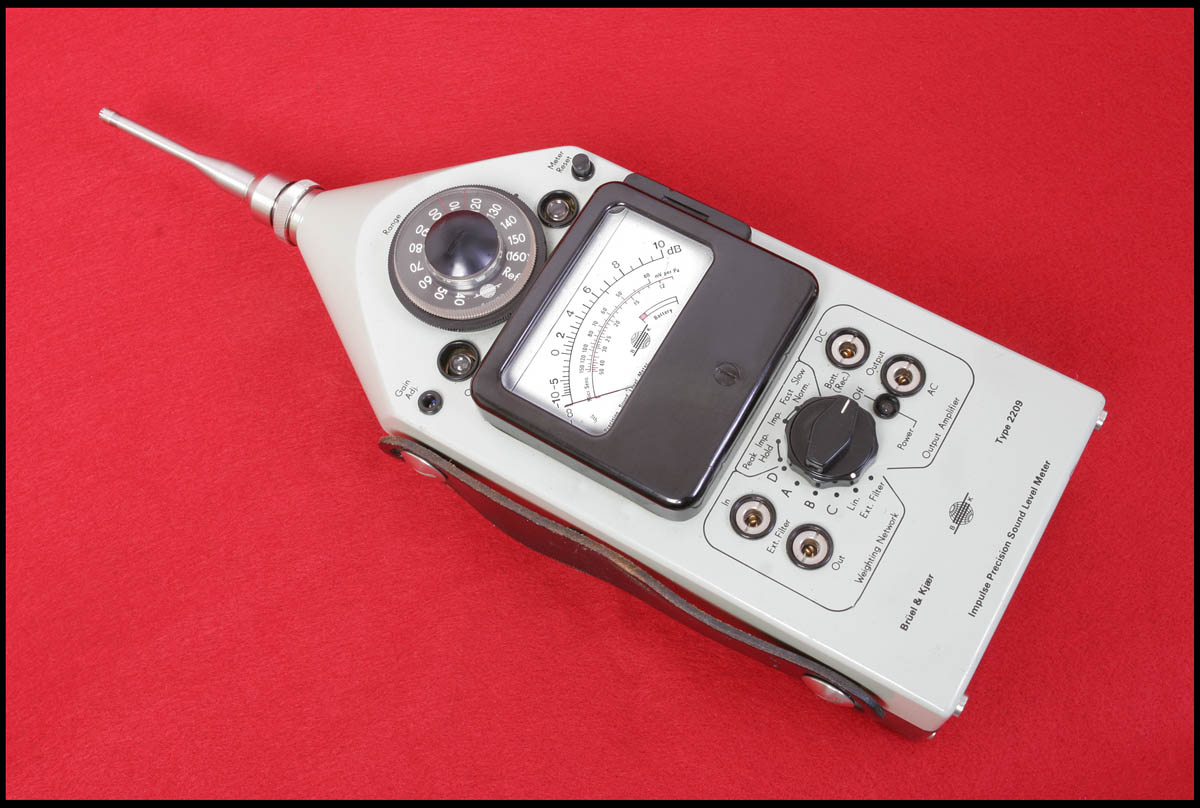

Suppressed gunfire is in the 120-140 dB range. Unsuppressed gunfire ranges from around 155-165 dB at the muzzle. That will drop maybe 6-8 dB at the shooter's ear.
The vast majority of sound levels quoted these days were collected with unsuitable equipment and are much too low. 140 dB is the limit for hearing damage from impulse noise and it is also the pain threshold for noise. That is noise above that will cause physical pain to the ears. Shoot a centre fire rifle without hearing protection and ask yourself if that hurts. If so then it is well over 140 dB.
Good table of shotgun, centerfire, and pistol dB levels here:
http://www.freehearingtest.com/hia_gunfirenoise.shtml
Those SPL's are roughly 5-10dB too low. Likely because they were collected with a sound meter than was not fast enough to capture the event peak. There are only a few systems available today that are fast enough for this kind of work and they are either difficult to find or expensive or both.
This is like the one I use.
